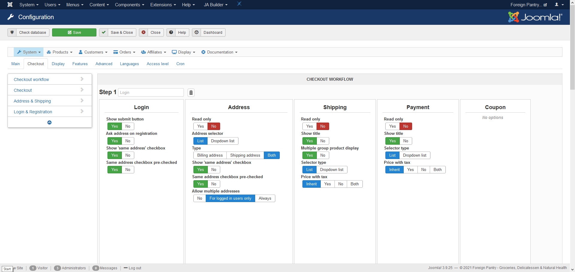

  • Posts: 121
5 years 5 months ago #330423
I couldn't work out what to do following your previous instructions. Here's the relevant screen. What do I need to change?
Last edit: 5 years 5 months ago by andrewwinkler.
  • Posts: 86081
  • Thank you received: 14189
5 years 5 months ago #330438
I would recommend you to first read this tutorial which explains how to modify your checkout workflow:
www.hikashop.com/support/documentation/4...eckout-workflow.html
Once you read it and understand how this all works, our messages here should be easier to understand.
