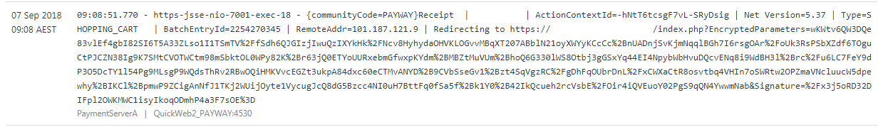

I've had word back from the bank and they say and attach below. Please help as I woudl like to have the payment status updated.
I’ve taken a look at the logs from our end and I can see that we are successfully posting back the transaction information to your URL with no errors.
Here is an example post.

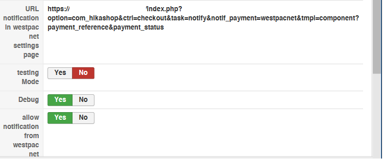

I used this one;
https://xxxxxxxxxx/index.php?option=com_hikashop&ctrl=checkout&task=notify¬if_payment=westpacnet&tmpl=component?payment_reference&payment_status
Please note that I have blanked out our domain for privacy reasons as this is a public area.
Their URL is coming back to our domain fine, but it says index.php?EncryptedParameters=
Maybe I put it into the wrong area in the banking setup? But I am following the guide :(

  • Posts: 26376
7 years 10 months ago #297835
I used this one;
I'm afraid that URL is not a valid URL.
You have twice the interrogation mark ; which makes the URL invalid and have for result a call from your payment gateway with missing required parameters, like "option=com_hikashop", "ctrl=checkout", "task=notify" and "notif_payment=westpacnet".

Hi Jerome,
Thank you for your reply.
I copied and pasted from this (inside the configuration page of HIKASHOP). Am I meant to change things to suit my needs ?
Thank you and I look forward to your reply.
P.S. this is an example of what happens after processing payment with the bank (note where xxxxxxx is, that's our domain);
https://xxxxxxxxx/index.php?EncryptedParameters=wKWtv6QW3DQe83vlEf4gbI82SI6T5A33ZLso1I1TSmTV%2FfSdh6QJGIzjIwuQzIXYkHk%2FNcv8HyhydaOHVKLOGvvMBqXT207ABblN21oyXWYyKCcCc%2BnUADnjSvKjmNqqlBGh7I6rsgOAr%2FoUk3RsPSbXZdf6TOguCtPJCZN38IjRs6cr5WzTFORgN8dfYct1ApFLDFebr6yBwTyJB8MYJ7V5cVDX7wXR%2Fq%2BZCsSX7%2BUKI4kStRxsKKahSYmbW5PK84TCJIIjXcwV2pj6ZkxOClX2h%2FnvihRpw%2FQ1%2F%2BBOYWDXeGKuhZMmeGwISzgQxgrDf3pJGxLceRUNoZChay3HhlblP8oqyD2Jqj9dXAqgaJAmiLz2foKhH6Pj%2F1Ubb4ICVudTTMltZhn531gm%2FuLqsULZRXOB%2Br1SjDhNHa5vOkze9vBNWfwcPqQDspuB1bGTuCOZNaN7Zzykb3FRbBCjPzpZYkiYc4k8UEcSyqufcQ23DnZZy2QtR0jiDGC3tDTWNGqATDnLjCHpTBADkgLQuo7WkzvV%2Bsrqit4qOBzaMXA32torF%2BVHrlifY0%2FQ9BPO&Signature=z7%2Br334%2FCD1P4w2%2BmXJwr6aZBp5xtuplSpFA1sP8bzE%3D

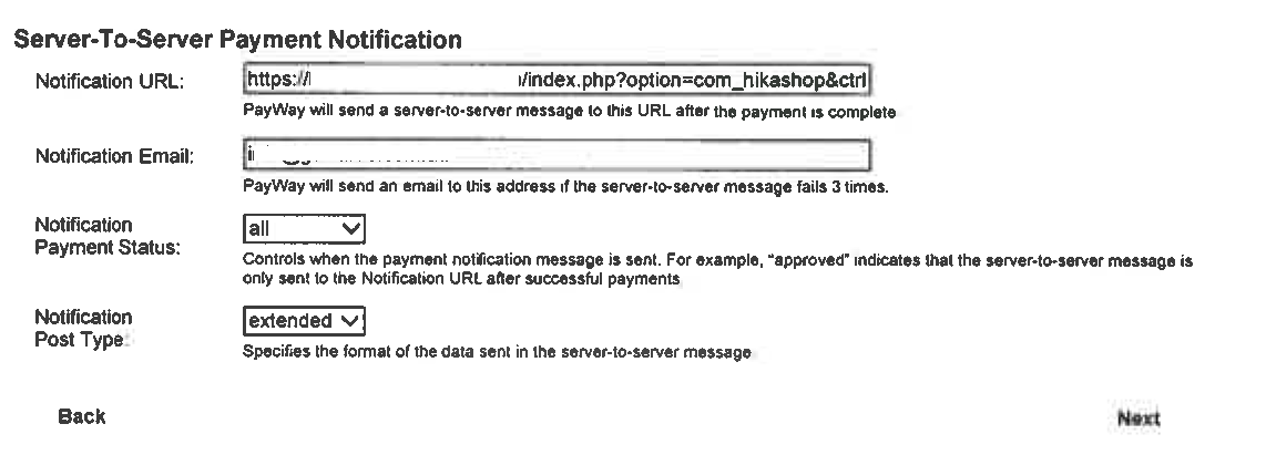

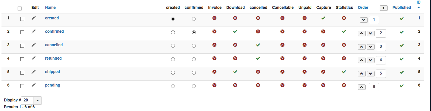

  • Posts: 12
7 years 10 months ago #297932
Please see my banking setup. I can confirm it's setup as per the URL listed in the payment settings in Hikashop.
Please help.

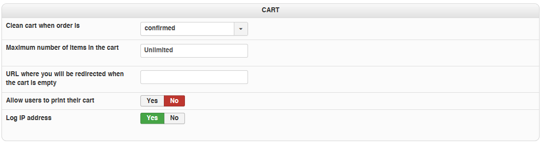

Please also see more of the setup within Hikashop.
Last edit: 7 years 10 months ago by datacore. Reason: adding more attachments

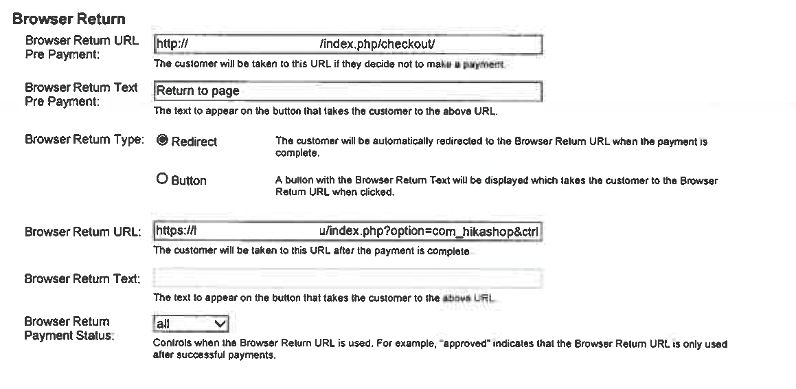

7 years 10 months ago #297944
So can you ask westpac about any information they have on the server-to-server notification ?
Because what they gave you is not the notification of the server-to-server but the browser return URL, which isn't used by HikaShop.
  • Posts: 12
7 years 10 months ago #297997
These are the only options you get for server-to-server and what I have setup already which isn't working:
Notification URL: (the return URL above that I use)
Notification Email: This email address is being protected from spambots. You need JavaScript enabled to view it.
Notification Payment Status: ALL
Notification Post Type: extended

7 years 10 months ago #298022
Let's check any point :
- Try to change in your Payway Merchant settings your Notification Url :
For :
https://xxxxxxxxxx/index.php?option=com_hikashop&ctrl=checkout&task=notify¬if_payment=westpacnet&tmpl=component;payment_reference&payment_status
