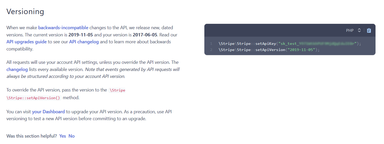

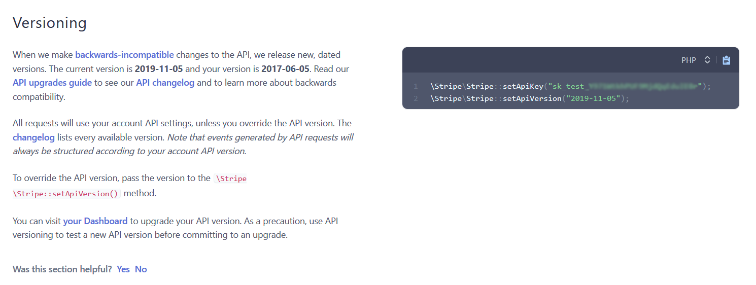

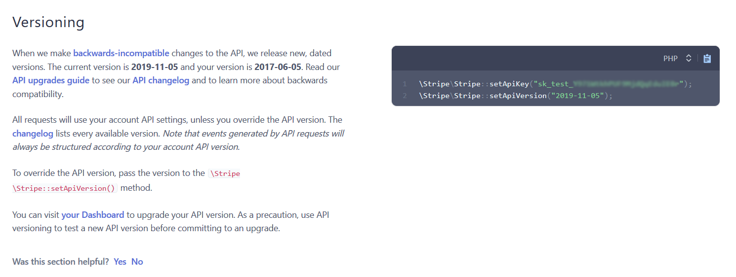

Hi Jerome
In my Stripe Dashboard I've noticed that I am not using the latest API version and it says I can upgrade to the latest version 2019-11-05 (the one I am presently using is 2017-06-05)
Would the upgrade to the latest api version affect your Stripe Connect V3 plugin I am using on my site?
In the Stripe docs it is written taht upgrading will affect "The structure of objects received with Stripe.js methods such as confirmCardPayment."
Could it be possible that using an old api version would affect customer data my dashboard is receiving and that would be the reason why "Customer" field is blank in the Stripe Dashboard as Earmaster pointed out ?
Before upgrading the api version Stripe strongly advise to do "versioning" see attachment
How and where can I add the code to do that in the Stripe Connect V3 plugin ?
Thank you for your time

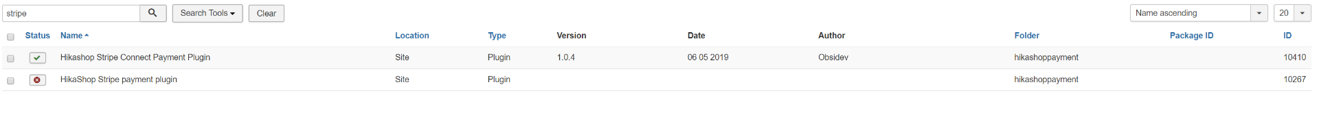

There are several version of the Stripe v3 plugin ; the latest one is 1.0.4 which use a different API than the 1.0.0
  • Posts: 112
  • Thank you received: 8
6 years 10 months ago #313214
Hi Jerome
I am using the Stripe connect v3 1.0.4
regards
  • Posts: 26386
  • Thank you received: 4078
6 years 10 months ago #313230
So the plugin is using the API version "2019-03-14'" since it's based on the v6.32.0 of the Stripe Library.
The version 7 of the library dropped the support of PHP 5.5 (and 5.4) ; we don't have enough feedback on customers usage to know if we should upgrade the library now or still wait on v6 since we are not using the latest API features.
I don't know why the Stripe library do not send the API version so I added that information within the plugin code.
You can re-download the version 1.0.4 of the payment plugin to get the patch.

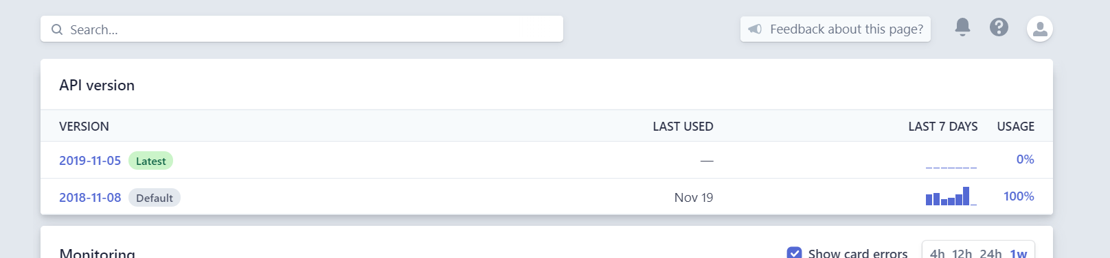

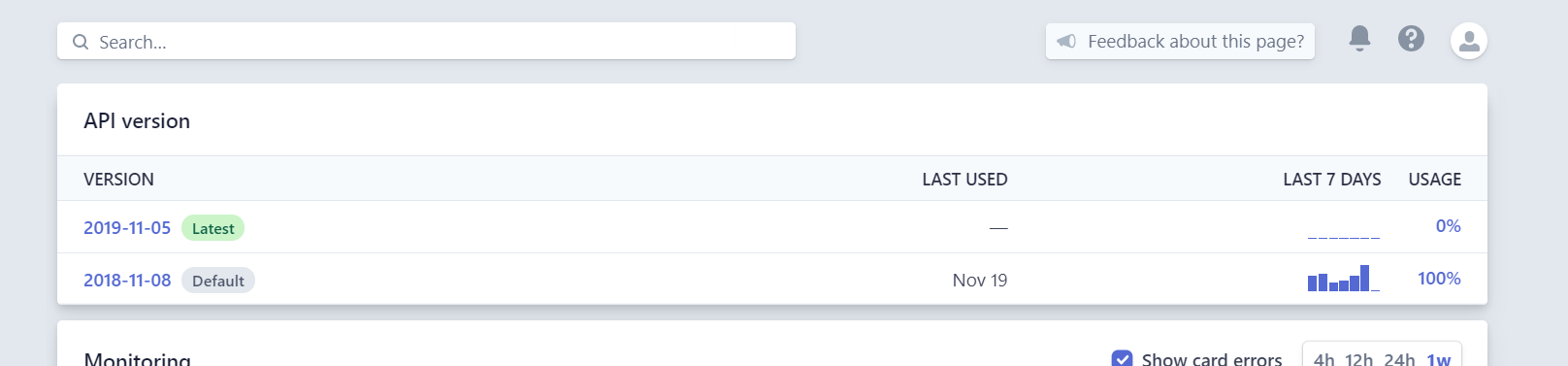

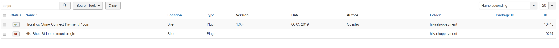

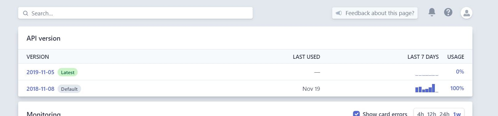

  • Posts: 135
6 years 10 months ago #313300
Actually, were using 1.0.4 but it seems that it gets served the Stripe API from November 8, 2018 (see screenshots)
  • Posts: 26386
6 years 10 months ago #313326
So I don't know how Stripe determine which API version you're using.
Because the Lib is the 6.32, published in April 2019, I did think that it will determine that you're using the API published just before.
Stripe is even saying that the version is already in the Lib but that it's possible to override it.
CF : stripe.com/docs/api/versioning
But that is strange that two users, using the same version of the plugin (with the same Stripe Lib), got a different value for the API.
With the addition of the override, it should force the usage of a specific API version in the Dashboard but the situation is still strange.

6 years 8 months ago #314310
Hi Jerome
I've updated my stripeconnect plugin 1.0.4 and now that the function setApiVersion sets the version to 2019-03-14 in my dashboard the payments were processed with that api version and not my old version (2017-06-05). Which is much better.
So it is essential to have that function" setApiVersion" setting the right version of the Api.
In my stripe dashboard I could update my Api version but only to the most recent version which is 2019-12-03 and not to the version of your plugin so I don't see the point ?!
Hope I made myself clear !!
Best wishes for the New Year 2020
Sophie

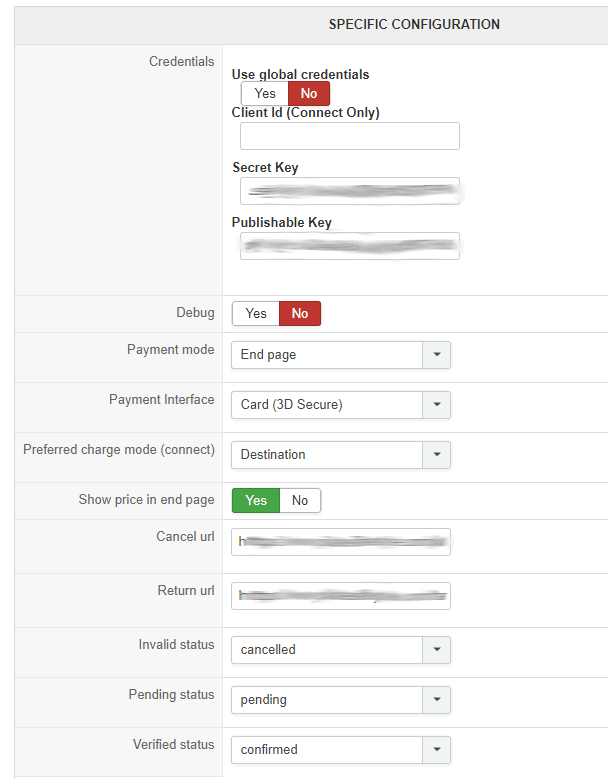

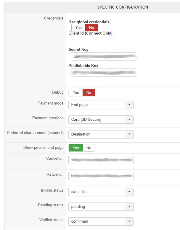

HikaShop Essential: 4.4.2
Stripe V3 with Connnect, HikaShop version : 1.0.6
Joomla! 3.9.27
After changing to V3 of Stripe plugin in order to sort out the SCA warnings, I am now getting warning messages in my Stripe dashboard regarding 2FA and saying I need to install/upgrade Stripe V3.
I questioned them about it as I have the plugin installed, that they recommend, and I received this in the email from Stripe:
...you need to upgrade in order to have 2FA support. The plugin is ok, but it is still making a tiny fraction of the charges through the Charges API. For more information on Stripe’s payments API, click the link below:
stripe.com/docs/payments/payment-intents/migration/charges
I have set up the plugin as per the documentation and I assume I have the latest version of the plugin as downloaded again today and checked the version number.
  • Should this functionality be available in the plugin (and I have not implemented correctly)
  • or is there are update I cannot see
  • or is it a new feature that needs including?
I look forward to hearing from you.
Greg
  • Posts: 26386
5 years 2 months ago #333853
2FA is Two Factor Authentication ; it's a security when you connect in the dashboard.
There is no relation between the plugin and 2FA.
And the plugin is already using "payment intents" with your version (in mode 3D Secure).
