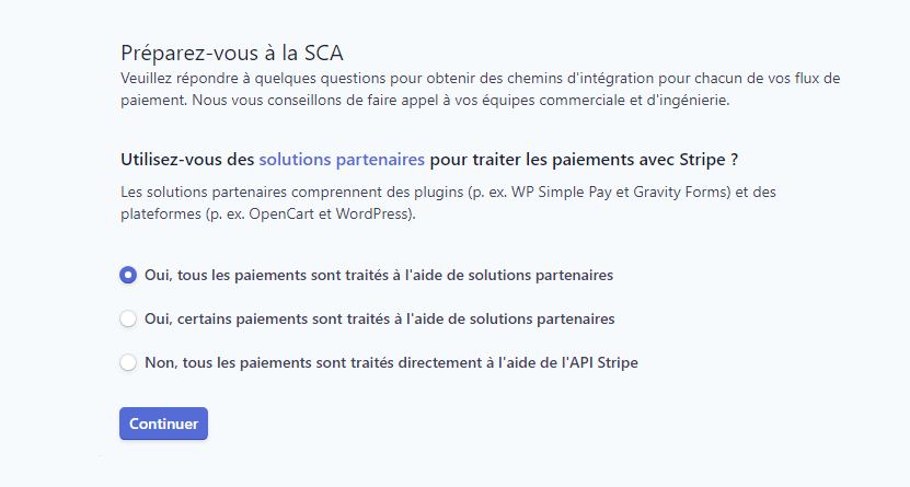

Regarding Stripe, for the moment Hikashop is not in the compatible solution list
stripe.com/partners/apps-and-extensions
and for the moment i don't know which choice should be done in the validation. Do we have to validate Stripe confirmation for SCA ?
Many thanks

2 - As the text tell you, a "platform" such as an e-commerce solution (or CMS) is a "partner". So yes !

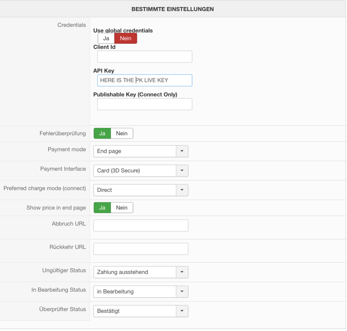

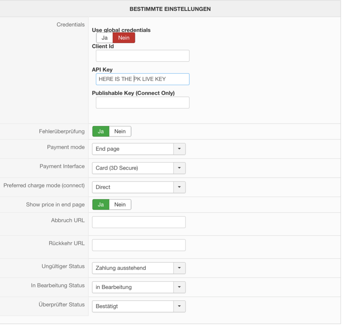

I'm very happy to see the new beta from the stripe plugin. I've just bought them and after the install unfortunately i´ve seen the same problems. We don`t need the connect functionality, just the SCA and later, other payment vendors like apple pay, google pay and so on.
We use the attached configuration, all the other fields are empty, just like you described. Unfortunately i see only a empty page on my safari, when i use the new plugin. I'm using the actual API-Version in my stripe account.
What's wrong in my configuration?
I appreciate your advice.
Thanks in advance

I had exactly the same problem when entering the credentials in the global plugin configuration. I got the Stripe Card Number field showing up by selecting "Use global credentials" to "No" in the Hikashop Payment Method configuration and specifiying the Stripe Secret Key (sk_test...) in the "API key" field and the Stripe Publishable Key (pk_test_...) in the "Publishable Key" field. "Client ID" stays empty as I am not using the Connect feature.
With this the payment and order confirmation will work, but there are still some bugs. For example if payment fails no error message but an obscore "[Object object]* message is shown. Also if payment succeeds the "Thank you message" that is currently hidden by "Display: none" in CSS is not unblocked and shown to the user.
I filed a support request, for the moment the plugin is not useable for me. Tried to fix the bugs in the code, but with all the connect related stuff and the future checkout integration it is really difficult to adapt to my use case.

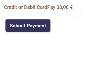

I installed the new version : the chckout/confirm page loads and the form is there but it is displayed inline and looks weird
I tested it with test card numbers and when I entered the numbers they shifted to the left and only the last 4 digits stayed on the screen.
and then a new Post Code input appeared ??
Hope you can improve it

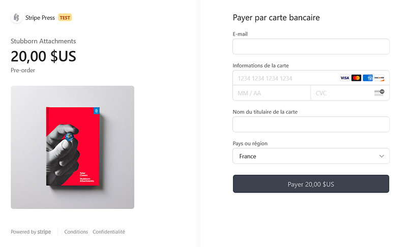

Hi Jerome

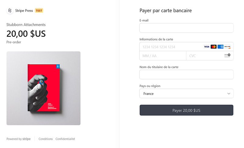

Are you thinking of writing a plugin in order to use the Stripe Checkout instead of the Stripe Elements ?
If so I would be very interested of using it rather than having the Stripe Elements form on my website
1 - I wouldn't have to worry about SCA as it is SCA ready and Stripe handles it
2 - It looks more professionnal and "safer" to use than a Stripe Elements form on my website
Thank you

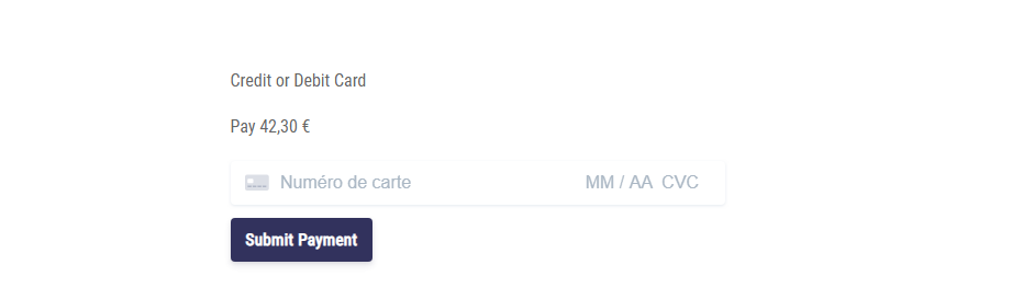

Hello
I just tested the beta plugin, everything sounds good excepted the design of the form.
I've attached some screenshots.
Have you planned to do something on this ?
