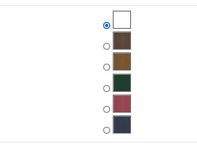

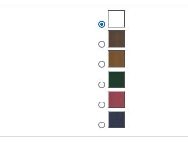

  • Posts: 51
3 years 6 months ago #348541
I am updating this site to Joomla 4 and found that the styling for the Color images has been lost.
I now get the vertical display not the horizontal display.
Joomla 3 display:
Joomla 4 display:
3 years 6 months ago #348564

  • Posts: 51
3 years 6 months ago #348592
Ok, Here is the link to the J4 page.
Last edit: 3 years 6 months ago by Philip.
3 years 6 months ago #348601
Thanks for your returns ! This will able us to update our Documentation, here .
You need to add these commands in order to have the expected results :
table.hikashop_product_characteristics_table input {
    display: none;
table.hikashop_product_characteristics_table div {
    display: inline !important;
    padding-left: 5px; // optional
