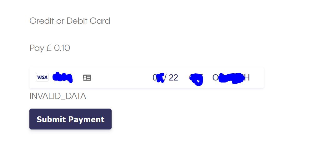

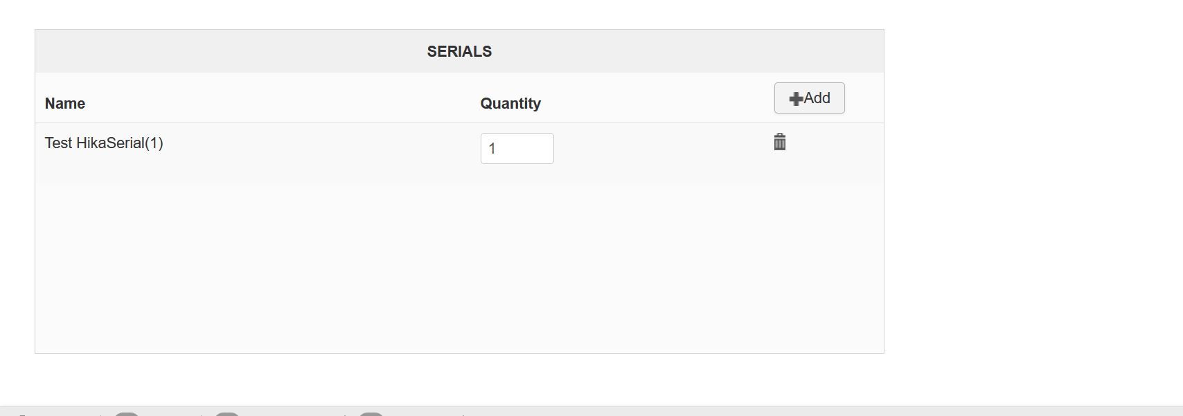

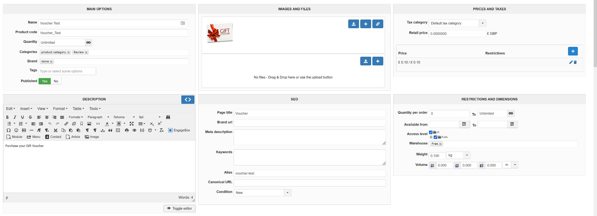

4 years 9 months ago #335702
Hi, so for some reason all other products seem to be working fine and you can pay with no issues. The vouchers give the attached error, just saying INVALID_DATA. I have also attached two files for the Voucher product. It does create the serial if I manually finish the order in the backend, but need to test the email etc.
  • Posts: 26355
  • Thank you received: 4068
4 years 8 months ago #335706
CF : www.hikashop.com/support/documentation/2...ipeconnect-form.html
Tips
Stripe do not accept payments below $0.5 / €0.50.
We recommend to set-up the minimum price in the plugin depending your currency.
For more currencies stripe.com/docs/currencies

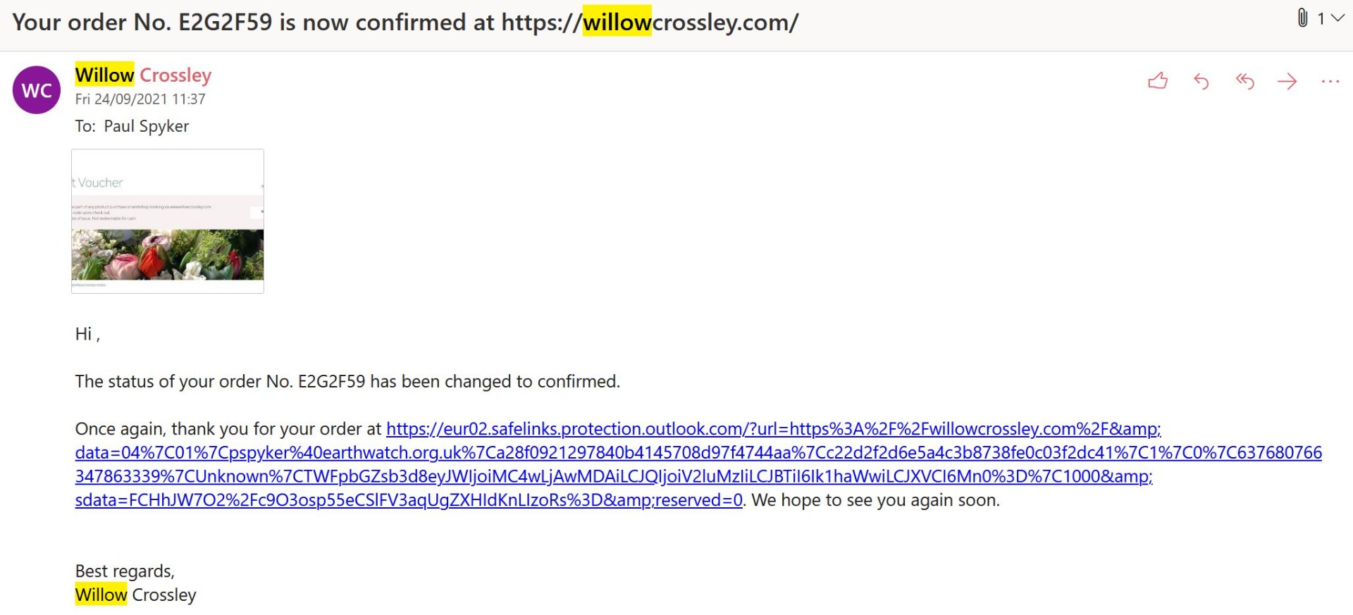

4 years 8 months ago #335983
Hi, I am just trying to get the text in the email. The issue is that the serial is not showing in the email that is sent to the customer. See attached for the email the customer receives. Do I need to switch this on somewhere?
  • Posts: 26355
4 years 8 months ago #335988
Looking at your email, that's not a "default" HikaShop email but a customized one.
Since there is no details regarding the order, I suppose there is no trigger for HIkaSerial.
You should open a new thread in the HikaShop section of the forum in order fr your "order customer notification" email.
