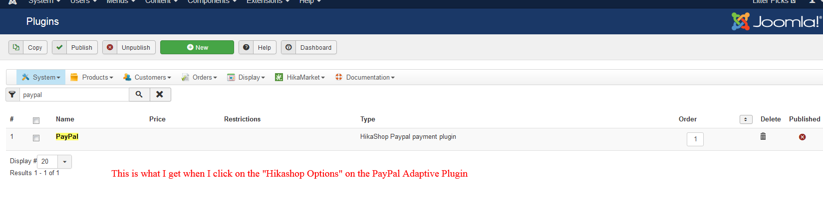

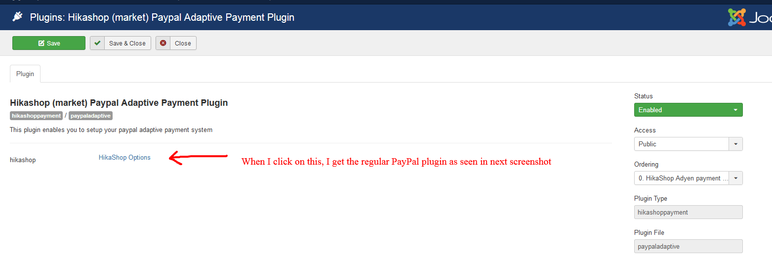

Thanks for reply. I've tried to use the PayPal Adaptive plugin, but can't get it to load. I'm attaching two screenshots showing the problem. I go to PayPal Adaptive in "Plugins", then click on "Hikashop Options" (screenshot 1), it takes me to the regular PayPal plugin (screenshot 2). It doesn't load the PayPal adaptive plugin itself.

8 years 9 months ago #283435
You need to create an instance for the Paypal Adaptive plugin, like explained in the HikaShop tutorial :
www.hikashop.com/support/documentation/6...st-sale.html#payment
The HikaShop payment plugin do not have settings in the Joomla plugin manager part ; they are made to work as "instances" to provide something much more flexible and powerful (thanks to the restriction system).
Once you will create the instance ; you'd have the interface as describe in the documentation :
www.hikashop.com/support/support/documen...aladaptive-form.html
