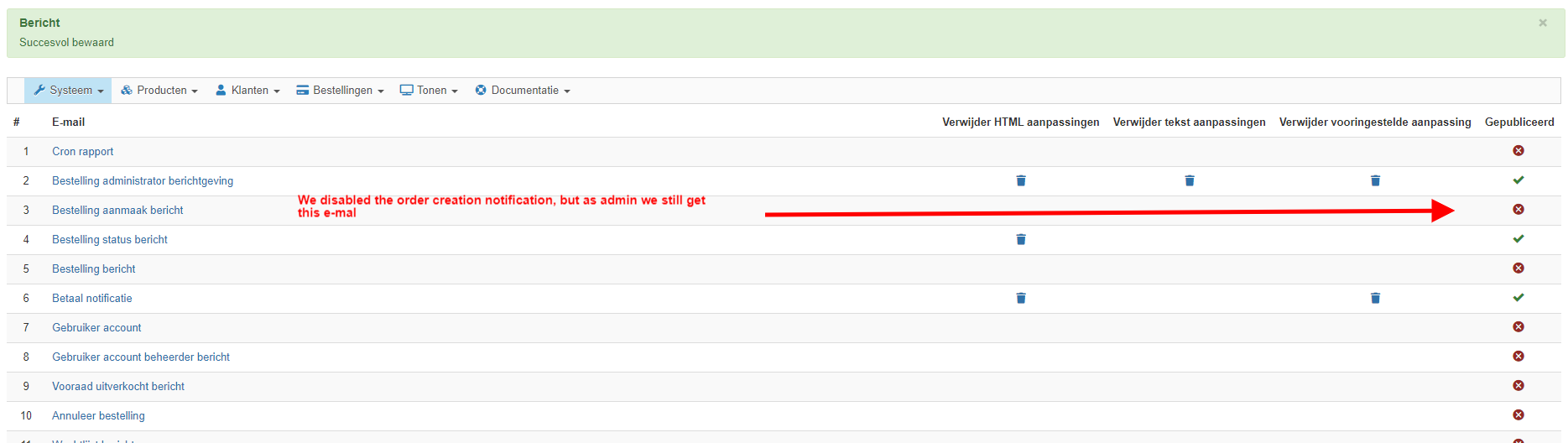

Thanks for your answer, i think what we forgot to mention is that we don't want the admin get the order created notification, only the confirmed e-mails, this because when someone goes to ideal and does not do the payment he gets a created email.. but this isn't paid.. so that is confusing for our client..(admin)
How can we accomplish that??
Hope you can help..
Mark
  • Posts: 86052
  • Thank you received: 14180
4 years 7 months ago #338210
For the admin, you want to disable the "order administrator notification" email there.
The admin will still get the "payment notification" email when the order is confirmed by the payment gateway, after the payment.

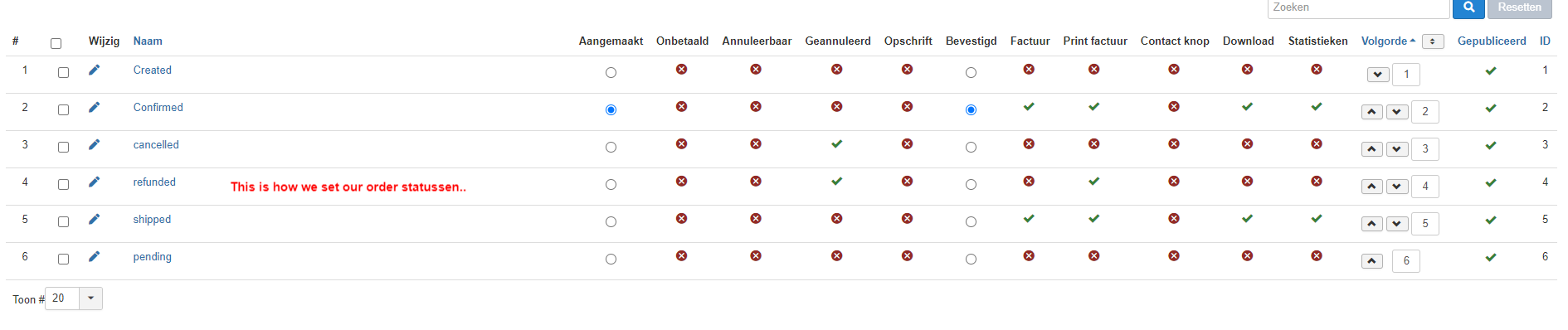

This should almost never happen as the status is normally not "confirmed" when an order is created.
But still, it's possible, you just need to adapt a bit the code I gave previously:
if($data->cart->order_status != 'confirmed') {
$mail->published = false;

  • Posts: 86052
4 years 7 months ago #338561
What that means is that the order status is not "confirmed" when the "order creation notification" email is sent.
If that is the case, then what you request
We want the order admin notifaction email to be sent only when the status of the order is confirmed. NOT when it is created,
is not possible since the order admin notification email is sent beofre the status of the order is "confirmed".
In that case, what I recommended before is better:
www.hikashop.com/forum/2-general-talk-ab...onfirmed.html#338252
This will not send the email when the order is created with the iDeal payment method, and thus it will send it for the "cash on delivery" payment method.
