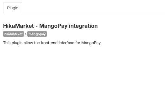

thanks so much for your answer, but I don't have that view on my hikamarket plugin.

When you edit the "mangopay" payment method
After that, there is a second mangopay plugin in the group "hikamarket".
It means that the first "mangopay" plugin is not in the group "hikamarket" but in the group "hikashoppayment".
You're editing the wrong one.

I'm really sorry but I don't understand.
When I able the mangopay on hikamarket plugin the field that you show me on your attachment doesn't appeared.

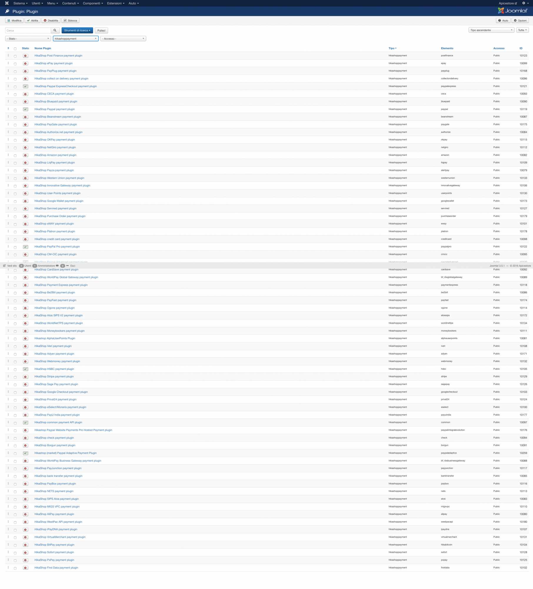

Hi, I configurate my store with my vendor but when I try to add the mangopay payment I can't find it, I have only paypal method.
On payment list it is active and also on plugin
