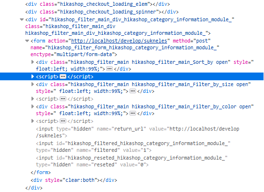

I have update and tried with protostar template, still no luck. "script" tags are removed from html.
So this is what i have now:
1. I use default filter.php with no modification and add this a bit of script:
<script>
jQuery('.hikashop_filter_main_<?php echo $filters[$count]->filter_namekey; ?>').addClass('open');
</script>
after this:
<div class="hikashop_filter_main hikashop_filter_main_<?php echo $filters[$count]->filter_namekey; ?>" style="<?php echo $height; ?> float:left; width:<?php echo $widthPercent*$filters[$count]->filter_options['column_width']?>%;" >
			<?php echo '<div class="hikashop_filter_'.$filters[$count]->filter_namekey.'">'.$html[$count].'</div>'; ?>
		</div>
The output of html before ajax filtering is done:

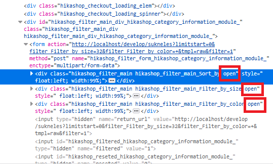

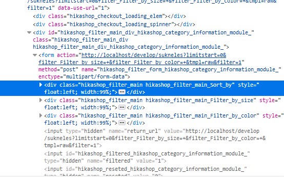

This is the output of html after ajax filtering is done:
If i use hikashop.js downloaded on "com_hikashop_business_v4.2.0_2019-07-18_12-18-08" The html is like this:
As you can see the "script" tags are also removed but jquert addclass function is still executed. All filter have class open...

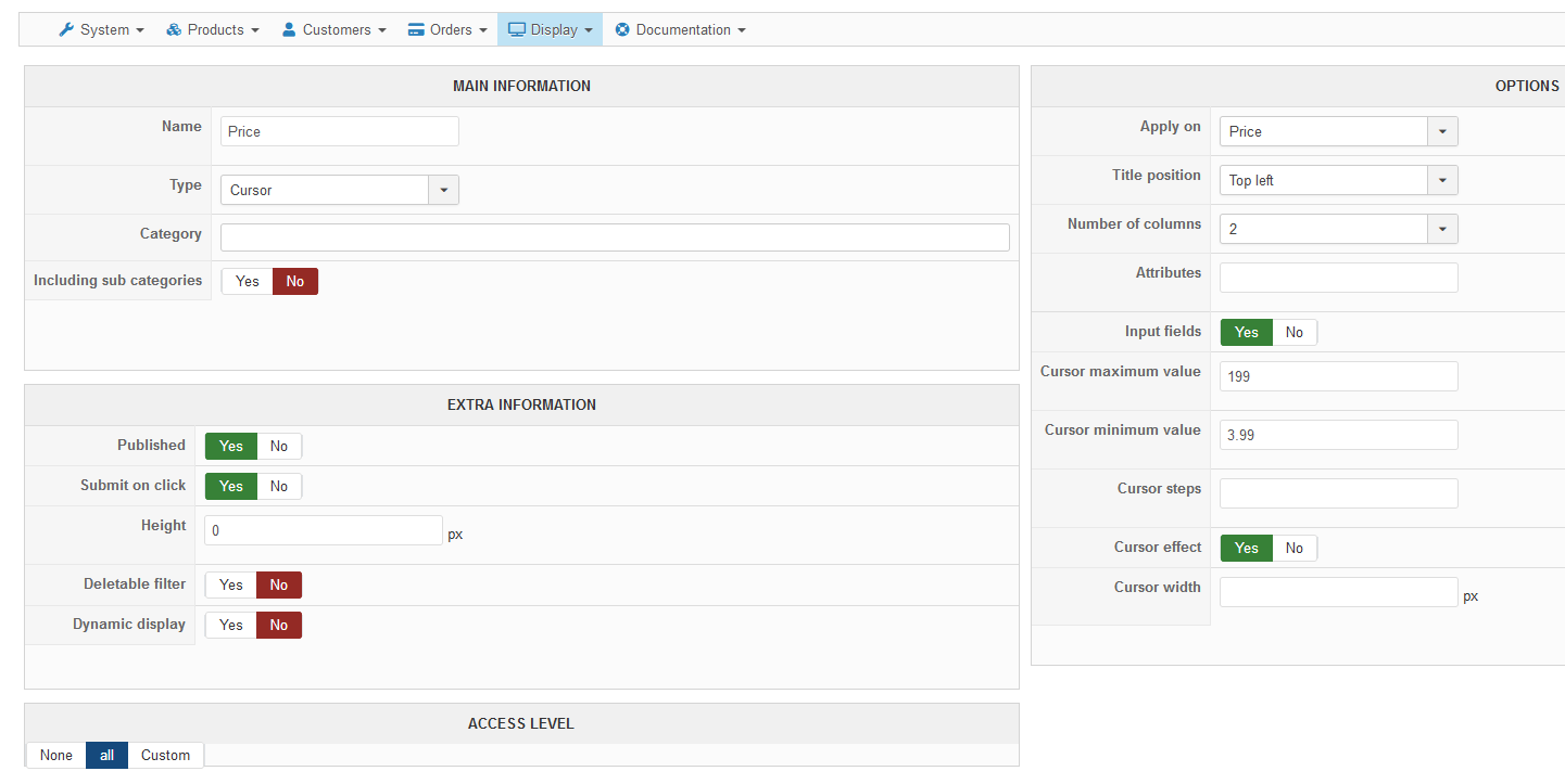

So it seems that the price cursor is giving issues. If i unpublish it then everything works fine.
Here are the settings of it.
Hope you can reproduce it.
Thank you

  • Posts: 86080
  • Thank you received: 14188
7 years 1 month ago #309116
Ah yes, I was able to reproduce it with the cursor filter. It comes from previous modifications we had to do when implementing the input fields. I've added a patch for that on our end.
