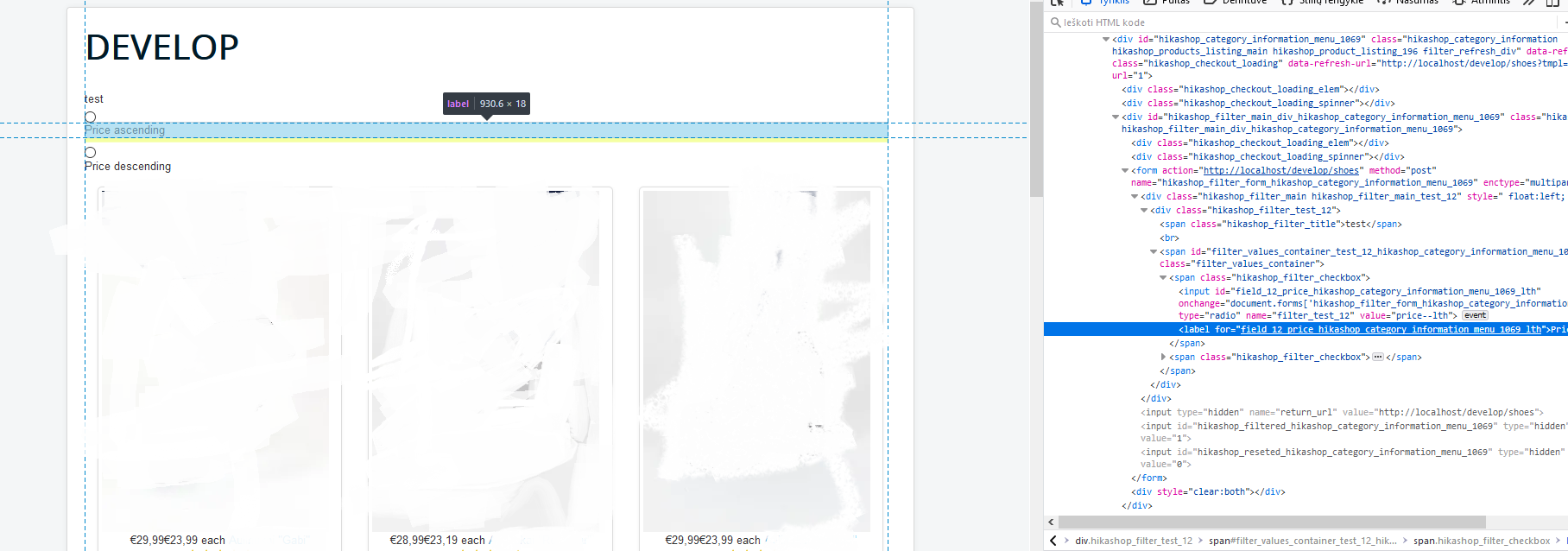

Just installed Hikashop 4.2.0 on localhost and seems cant find ajax filters. Filters are working as it was, reloading the whole page. Looking html i see it has changed... Trying with blank protostar template. Maybe i miss something?
Here are some screenshots:

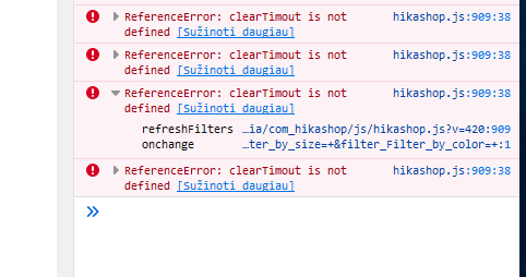

3. Setting any filtering to submit on click to "YES" and then fast double tap filter (checkbox as example) or button "FILTER", console throws error "ReferenceError: clearTimout is not defined"

Please re-download HikaShop package to get the fix regarding the JavaScript issue.

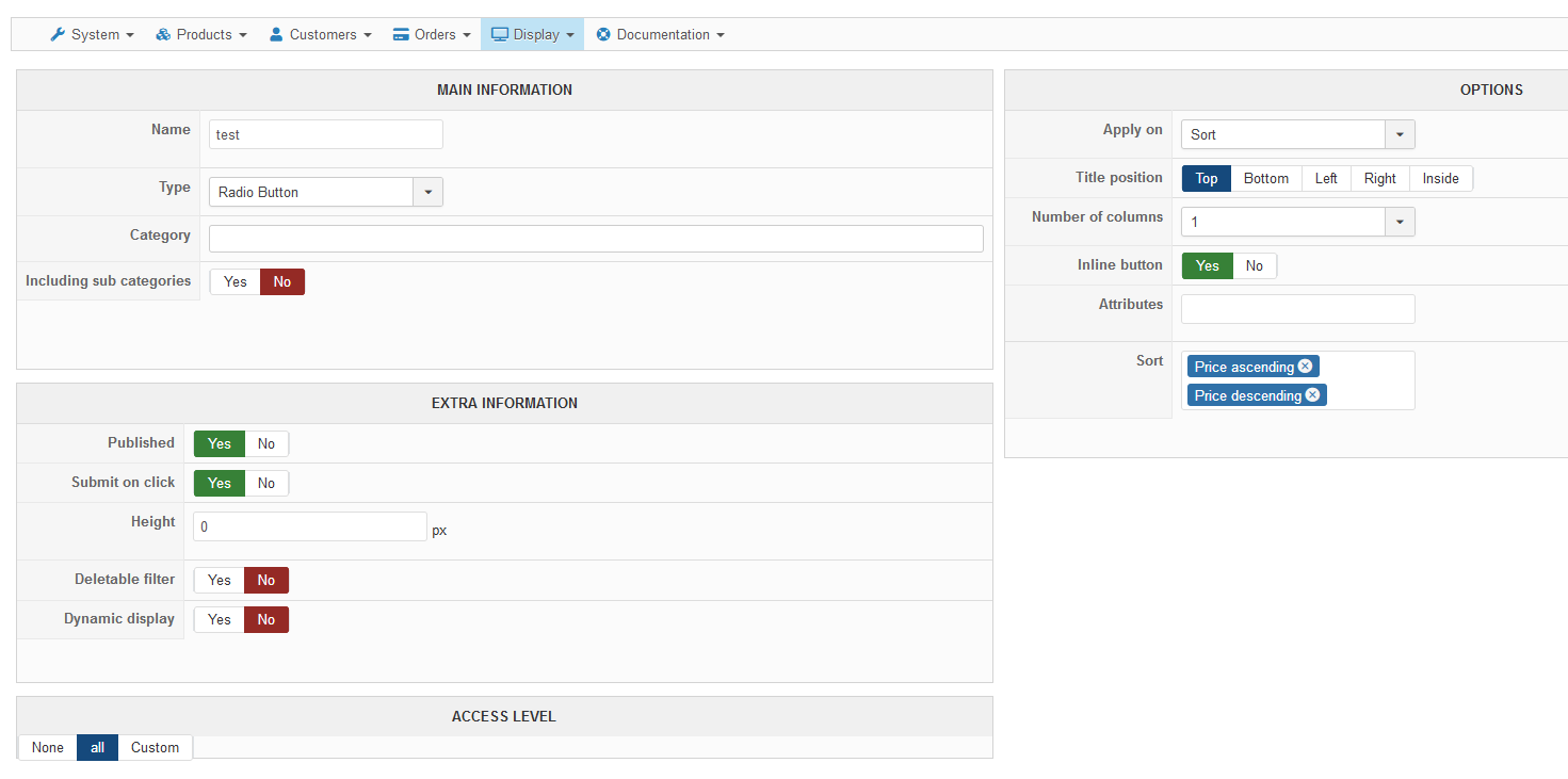

1. It is easy to reproduce the issue:
1. Create some filter, as example sort or something with checkbox
2. Create menu item of product listing or category listing
3. Via that menu item product options settings set Filters display to "YES"
4. Try to filter and see behaviour
Seems i am not the only one who have some issue like this: www.hikashop.com/forum/install-update/89...the-menu.html#308637

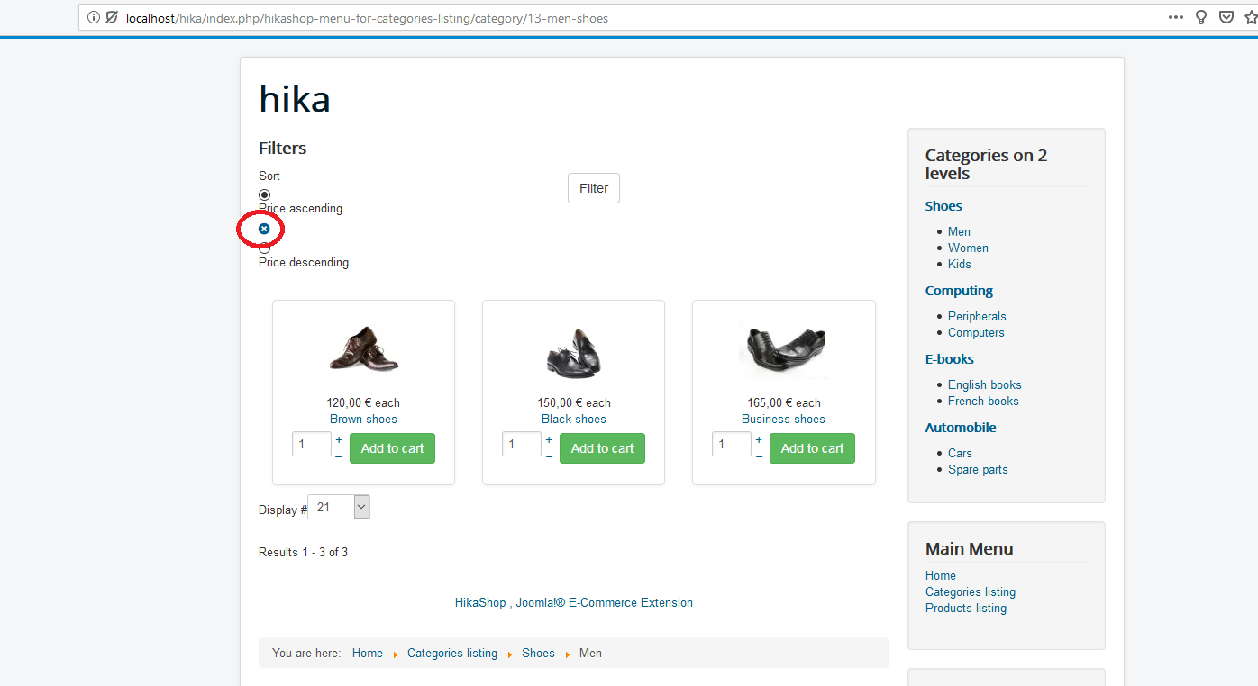

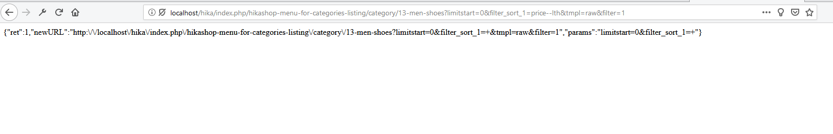

2. Sometime when filtering we get blank page with url params in it.
Here is the example which was done like this.
1. Installed Fresh Joomla 3.9.10 and Hikashop 4.2.0 with demo content. Created sort filter with radio. Filtering seems working but after pressing delete button i get this page:

  • Posts: 86212
  • Thank you received: 14220
7 years 2 months ago #308719
Thank you for the details. I was able to reproduce the issues and added some patchs for them. Please download again the install package on our website and install it on yours and it should work much better now.

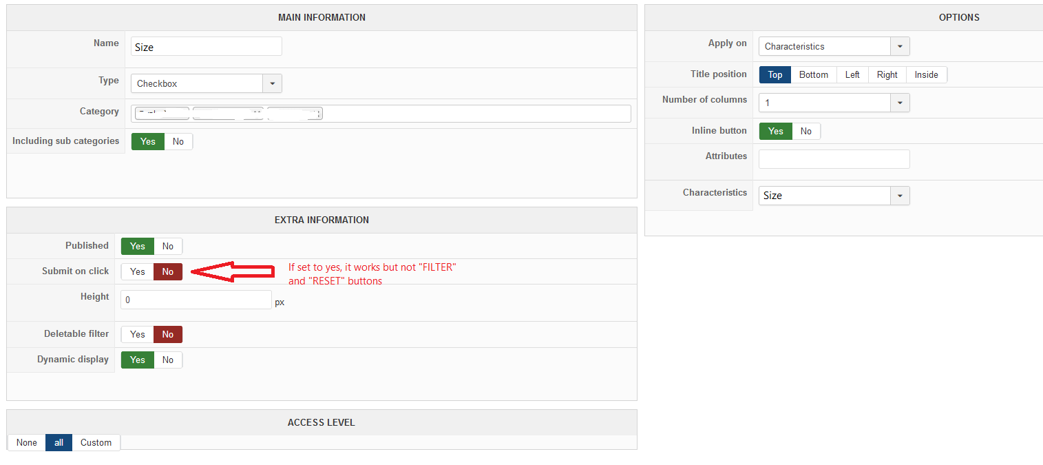

It looks a bit better but there are still some issues.
Now filtering for sort does work and if filter type of checkbox is set to submit on click to "YES" this filter does work. However if i set submit on click to "NO" and try to filter with button "FILTER" it doesn't work. Same for reset button. It just nothing happens, no any action...

Nope, no view overrides but i found the issue.
Via Hikashop configuration-> Filter button position, setting it to "Right" or "Left" is fixing the issue.
So checked html and it seems if button position is set to "Inside". "Filter" and "Reset" buttons are missing some html "data-container-div"
Someone forgot to add:
<?php echo $attributes; ?>
For these buttons :)
Please take a look into it.
Thank you
