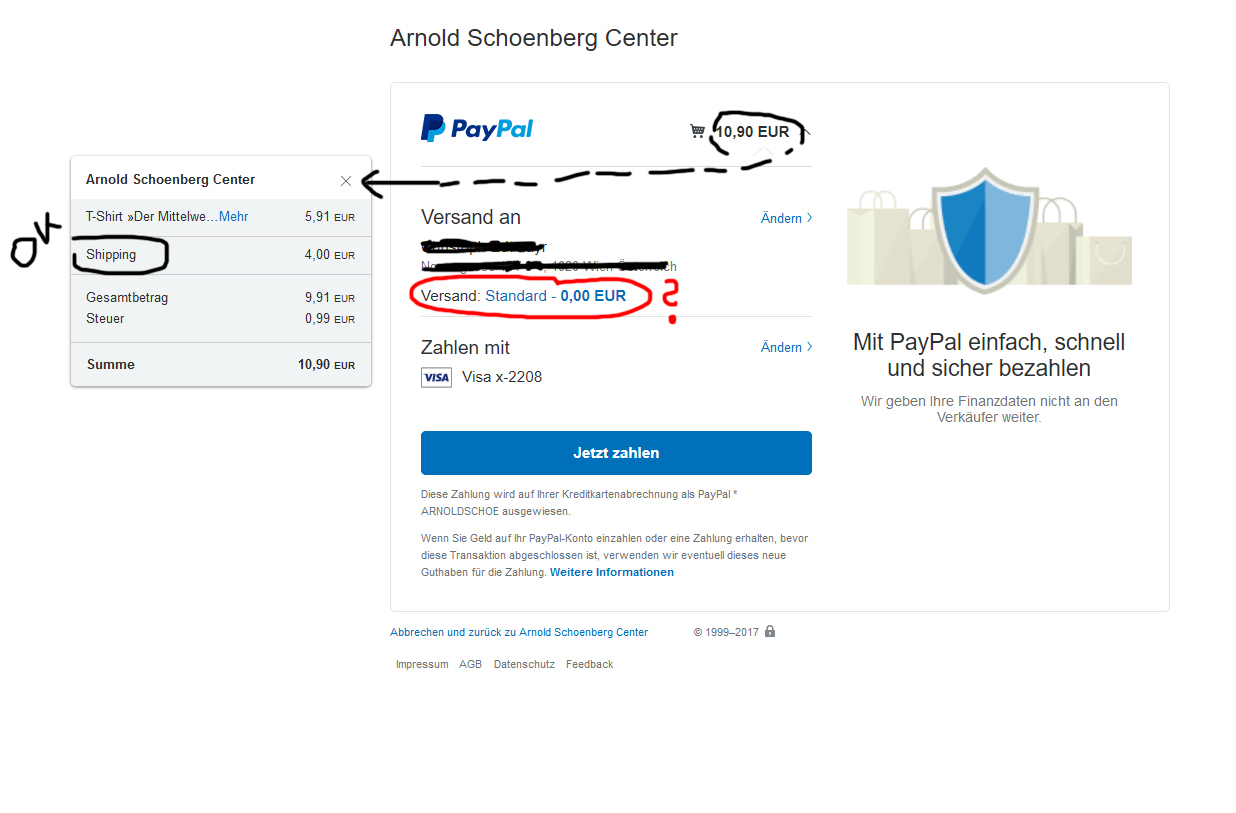

I had this problem too. At first PayPal wasn't accepting the address for shipping. I had the "Customer Address" set to Billing Address. But that doesn't work because PayPal does not allow shop owners to see a customer's billing address, so the shipping address will show up empty. I set "Customer Address" to Shipping Address, which makes more sense anyway, and that worked.
However I was now getting an extra shipping charge when I was already charging for shipping on the website. The solution was to remove all shipping options from my PayPal account. Under "Profile and Settings" go to "My Selling Tools" and "Shipping Calculations". Remove any shipping calculations here.
I had added USPS Standard Domestic because that was how I was going to ship. But this told PayPal to add a shipping cost because it did not receive a shipping cost from HikaShop. The shipping cost in HikaShop comes through to PayPal as another item purchased, not as a shipping fee. So if I purchases one item from my website, which includes shipping, PayPal sees that as I purchased TWO items, and tallies a shipping fee for two items.
I only added this to try to help explain the solution for others with this problem, and there are others with this problem. Hope this helps.
