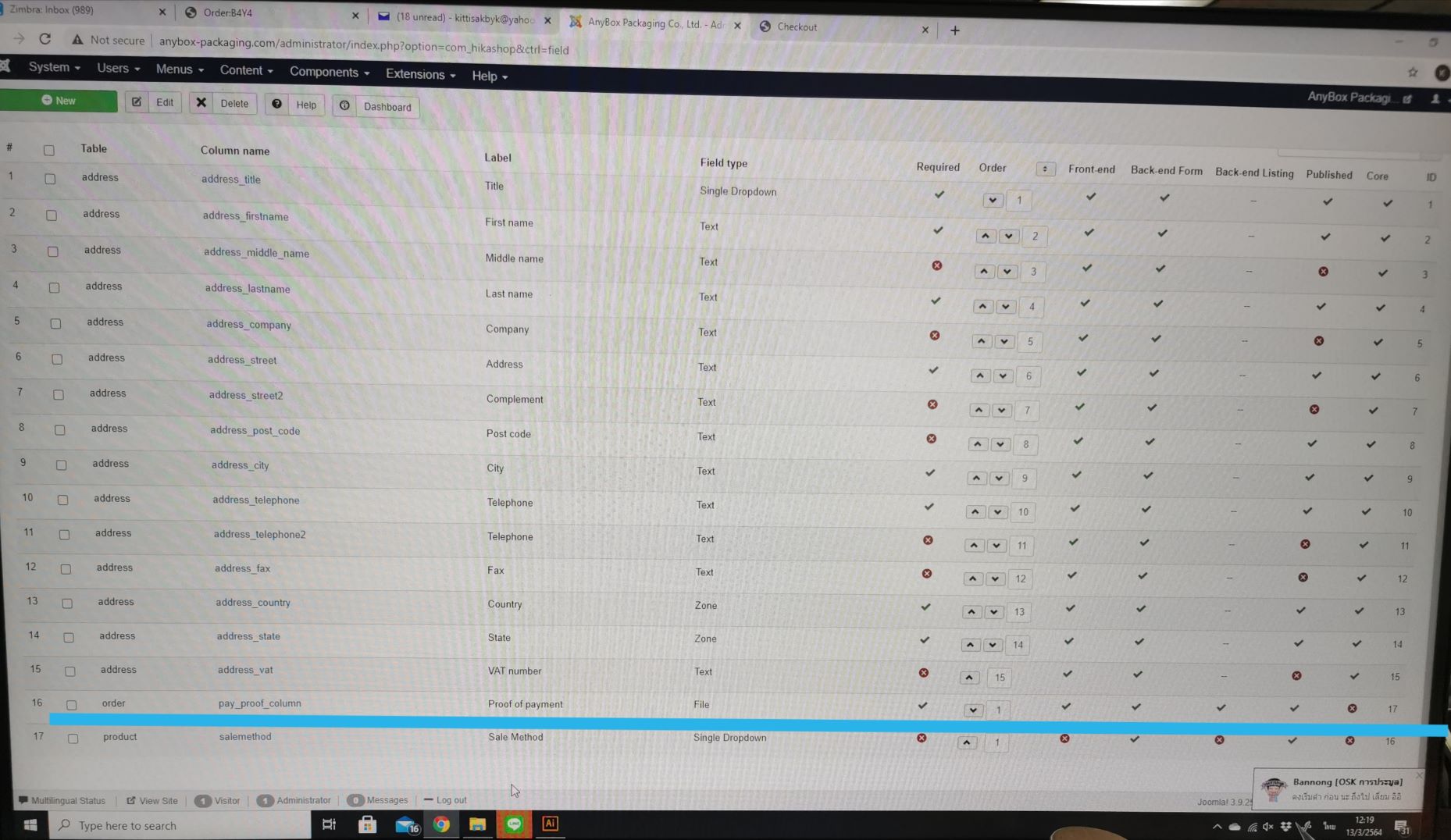

Dear all
I have 2 question. For a bank manual transfer method.
1. How to create form for the customer to send proof of payment (jpeg picture format) that link to the just submit order number automatically.
2. When an order submit and customer received "order create" notification e-mail. I would like to know how to insert link (something like submit button) in the e-mail to bring the customer to the proof of payment sending form (as I mention above and also link to the specific order number in that e-mail).
Thank you very much.

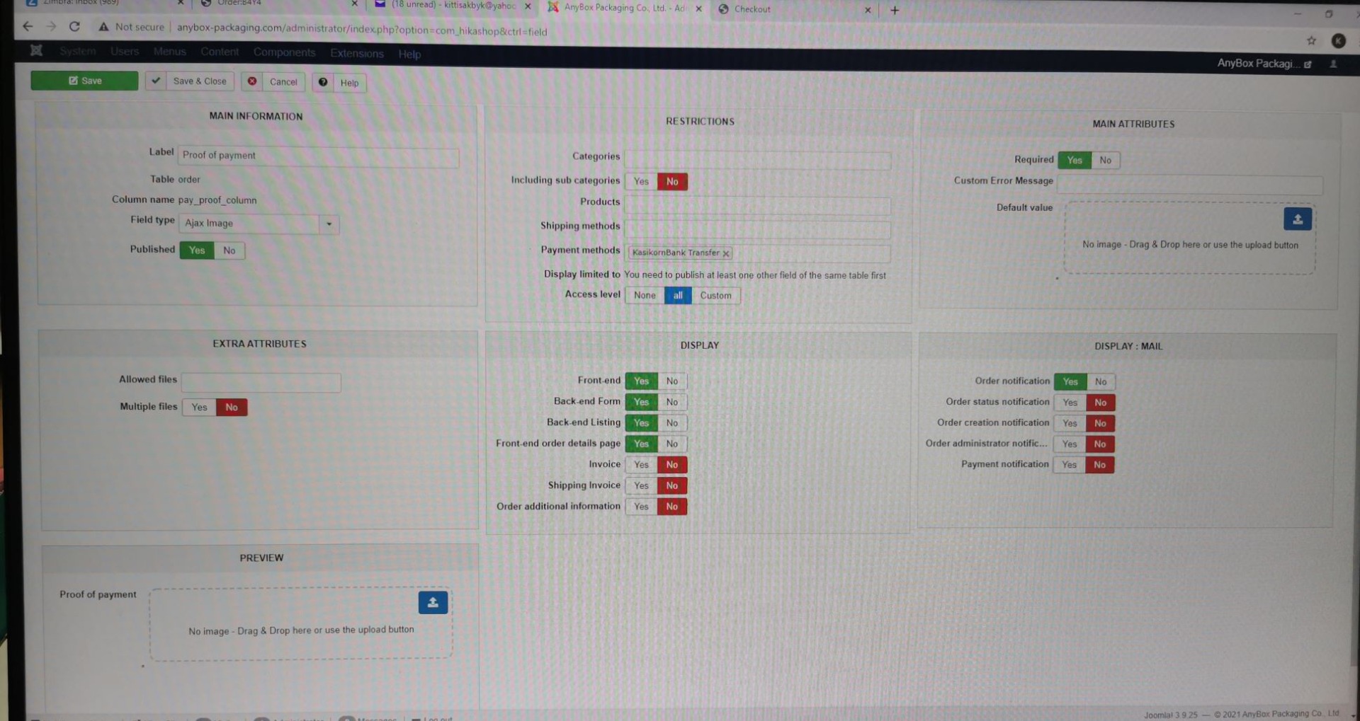

1. This is possible by using the Custom Fields, have a look on this tutorial .
In details you have to create an Order Custom Field, and define the fieldd as File, see my screenshot :
Note in the restriction part, the payment methods selected, this will authorize the custom field to be display, only if this payment method is selected.

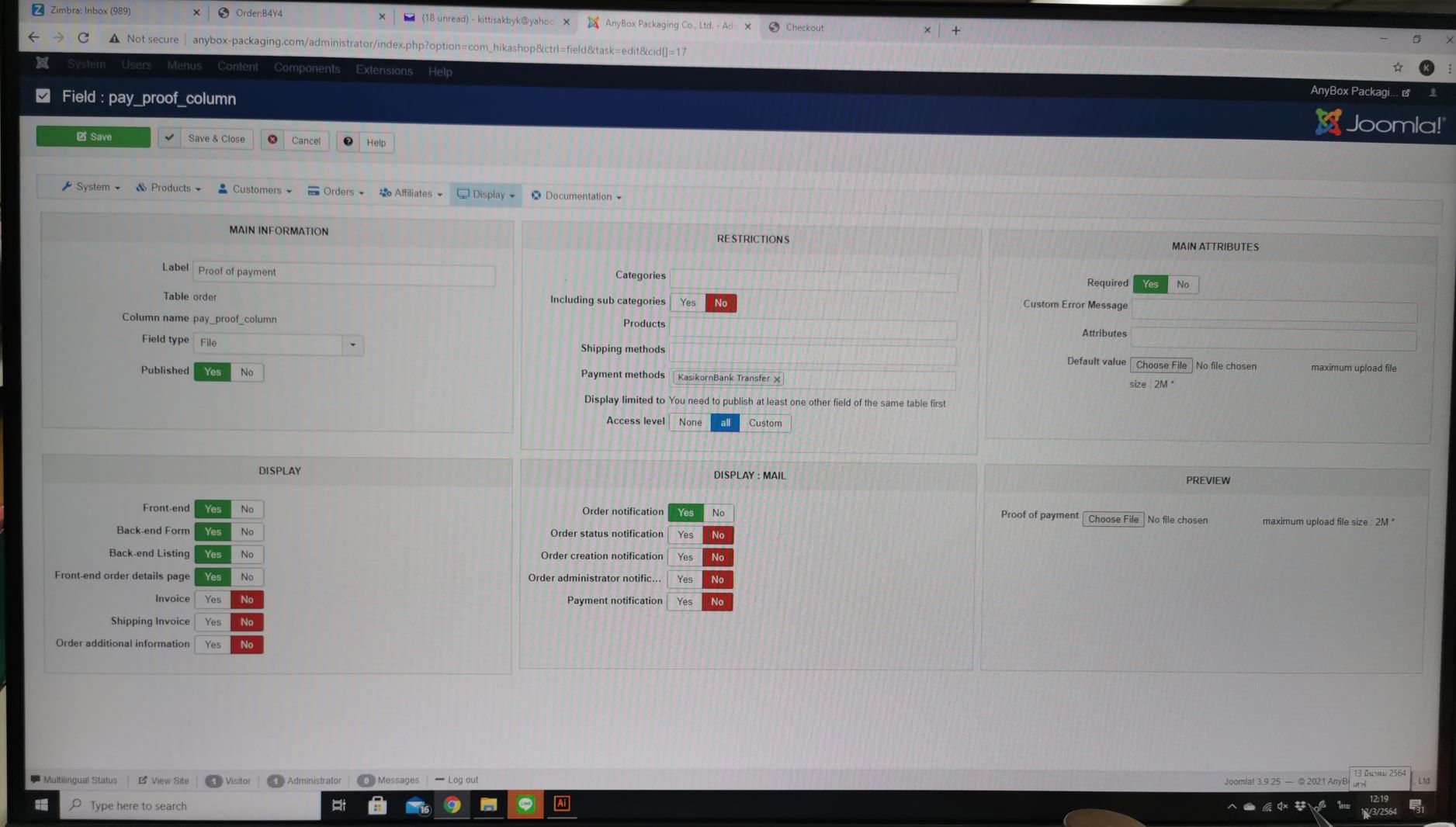

For the question 1., I have follow your instruction, everything is ok and look like I want. But when I try to finish check out process from my website front-end, I cannot upload anything to the Proof of Payment custom field.

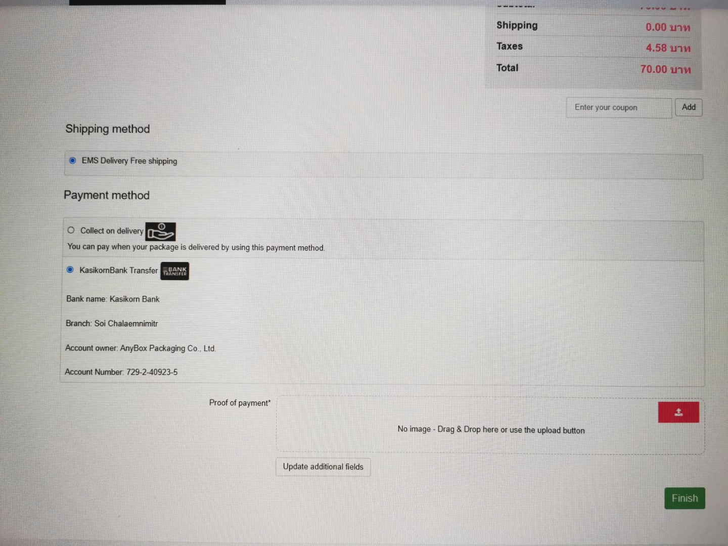

  • Posts: 10

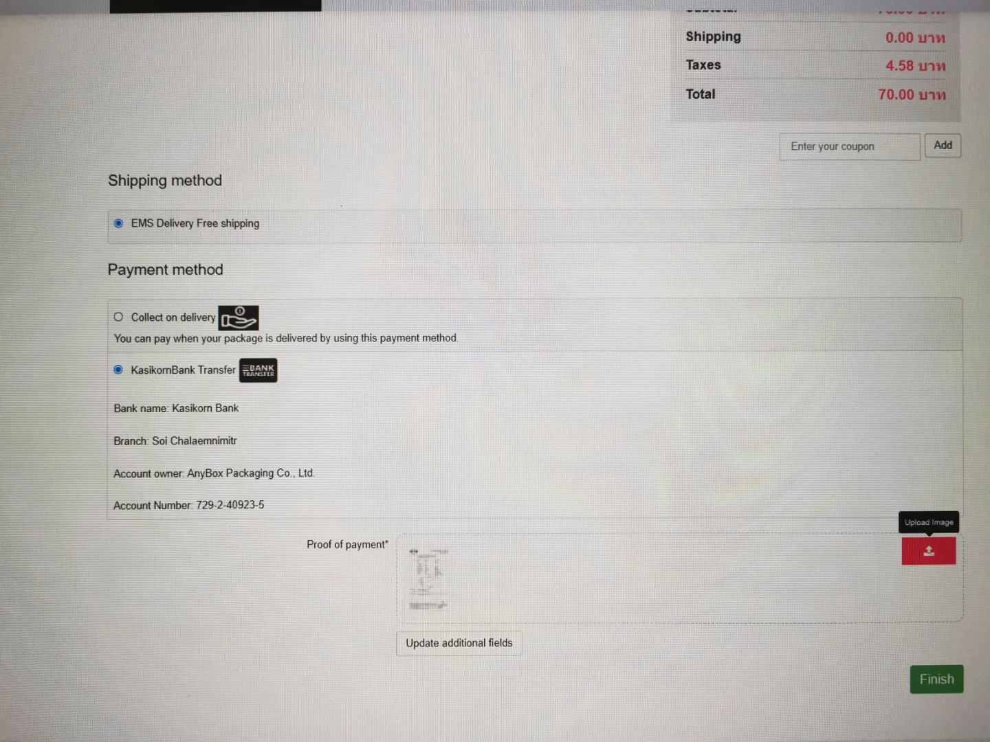

5 years 4 months ago #330755
Hello

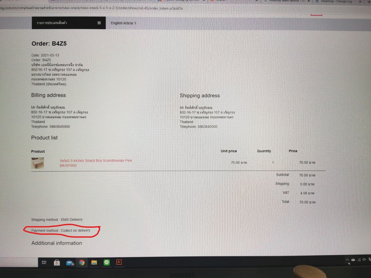

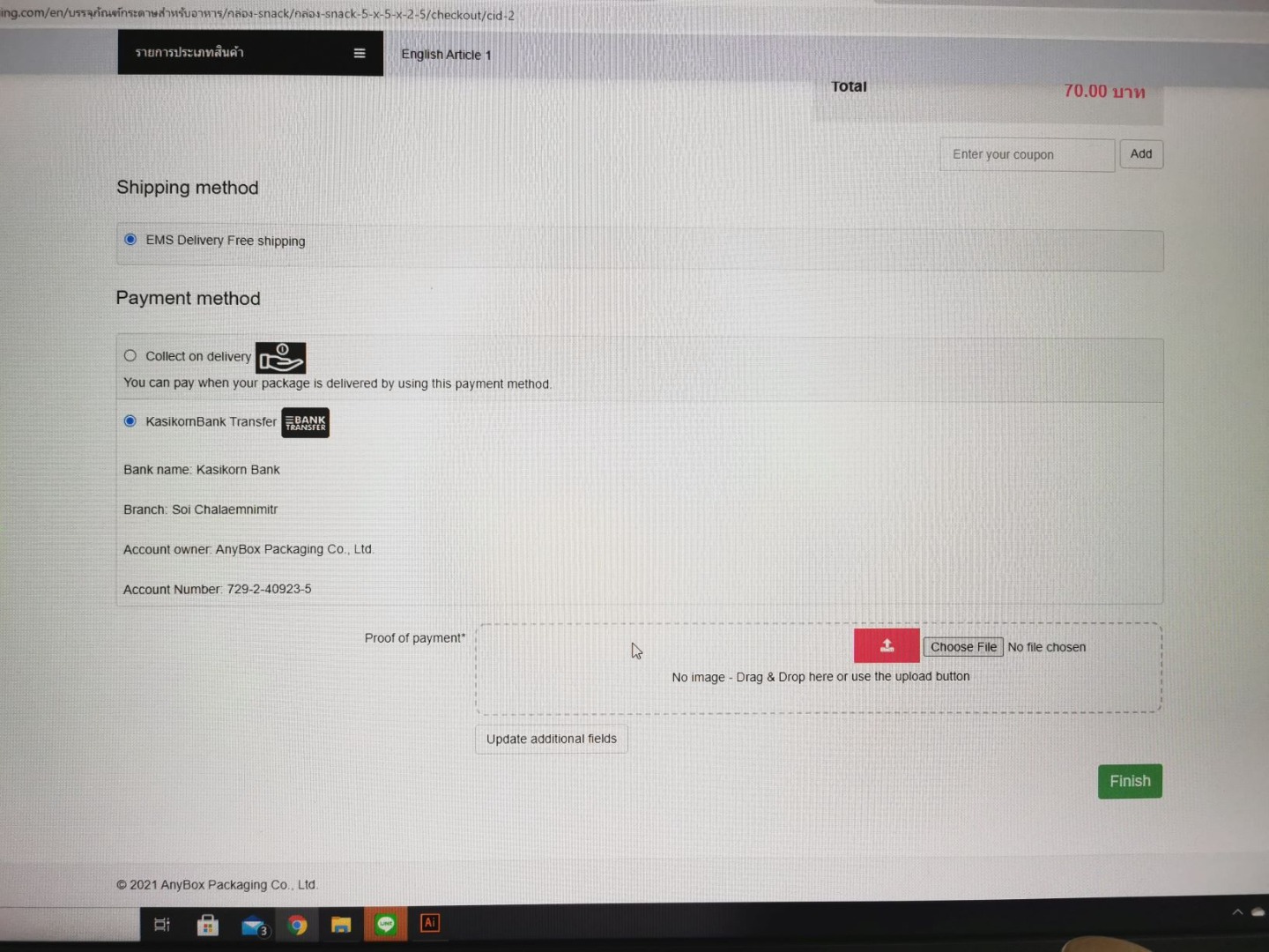

For 1, I have check to my web hosting service provider, they think the host configuration is not a problem. So I try to change "Proof of payment" custom field from File to Ajax image field type. It's work!! I can upload any images but the upload module look like to have 2 field type in it (see picture Name: No1 TwoCustomFieldTypeInOneModule). First time when click on it then the page go blank so I have to click back on the browser to go back to the check out page, now this time the upload module look normally (see picture Name: No2 Ajax image custom field) and I can upload picture to this field (see picture Name: No3 Uploaded Ajax image custom field).

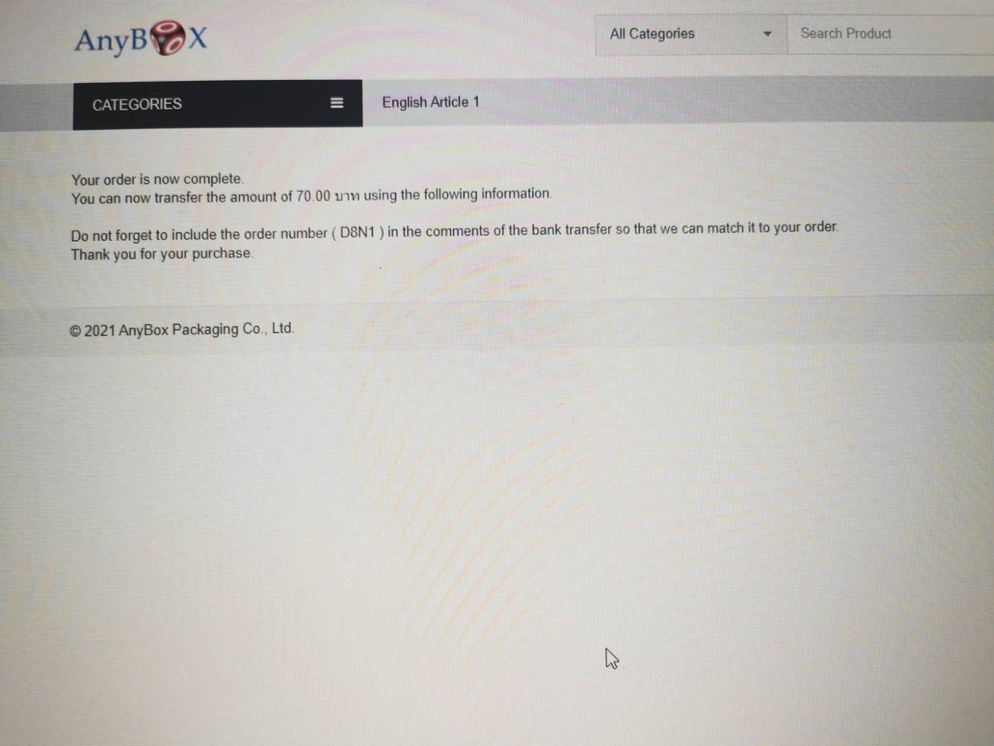

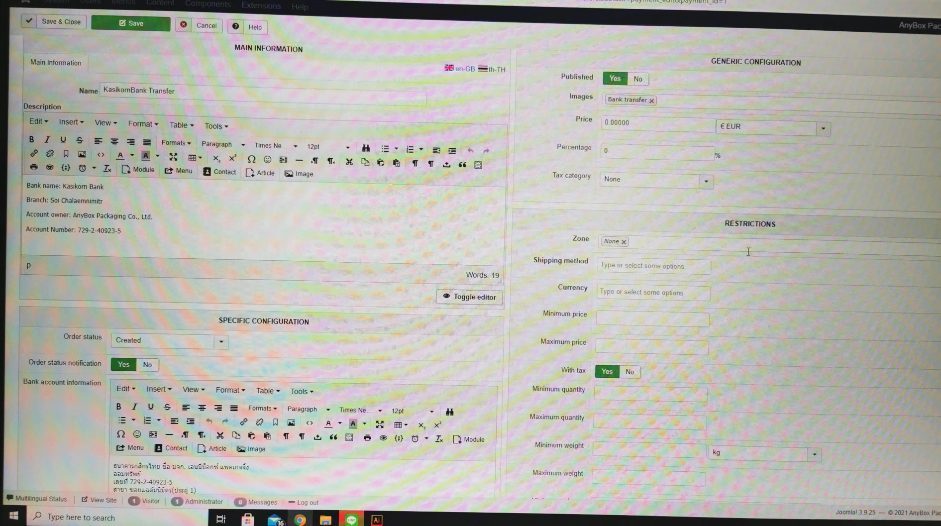

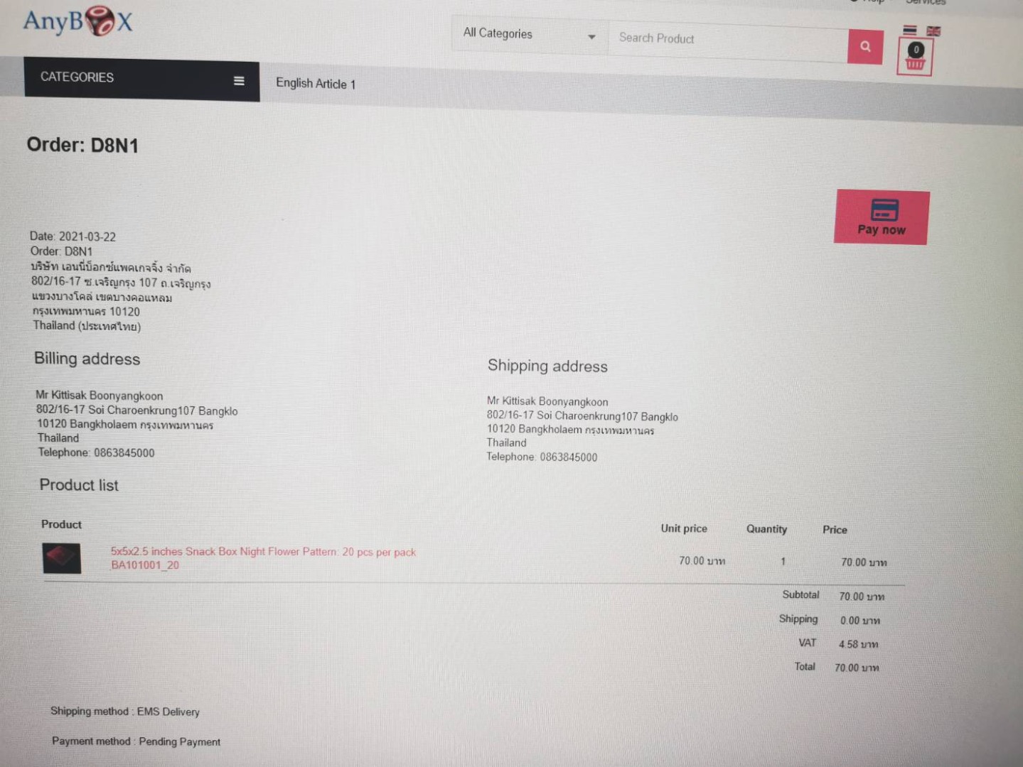

For 2, In the first time, I do everything follow your first advice. When I choose "Collect on delivery" option, I receive payment notification e-mail with link ("Pay Now" Button) to go back to make a payment again but in that link It has Order Number and payment option only (see picture Name: No4 Page link with Pay Now Button 1, No5 Page link with Pay Now Button 2) so I can not upload any image of the proof of payment.

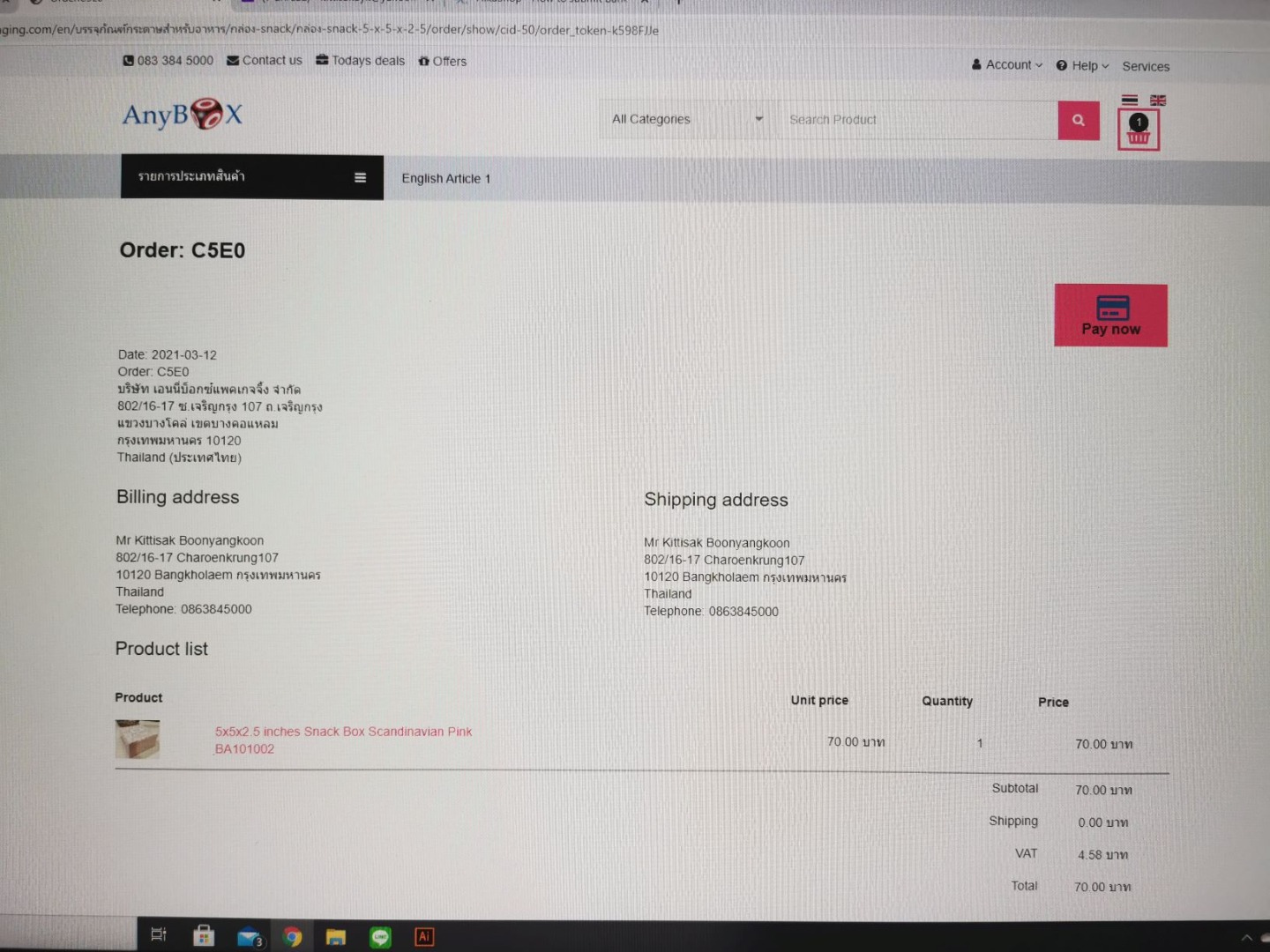

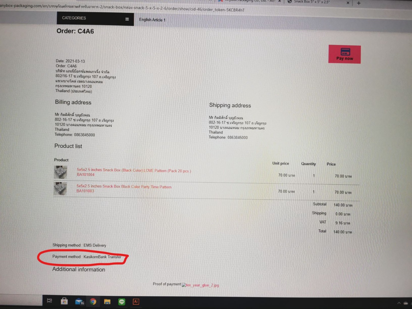

In the second time, I do everything follow your last advice. I change plugin name from "Collect on delivery" to "Paid later" ,make some translation override with my language and change custom field from File to Ajax image field type. In this time I can up load image on check in page as mention above but for a Collect on delivery(Paid later) option check out. They not have a link ("Pay Now" Button) for payment anymore (see picture No6 Page link from pending(paid later) notification e-mail ) but the link will appear in case if I select Bank transaction payment instead (see picture No7 Page link from order create(choose bank transfer) notification e-mail ).
I have attached how I produce my web site picture following the attachment. And you may try to check on my web following url. ( www.anybox-packaging.com )

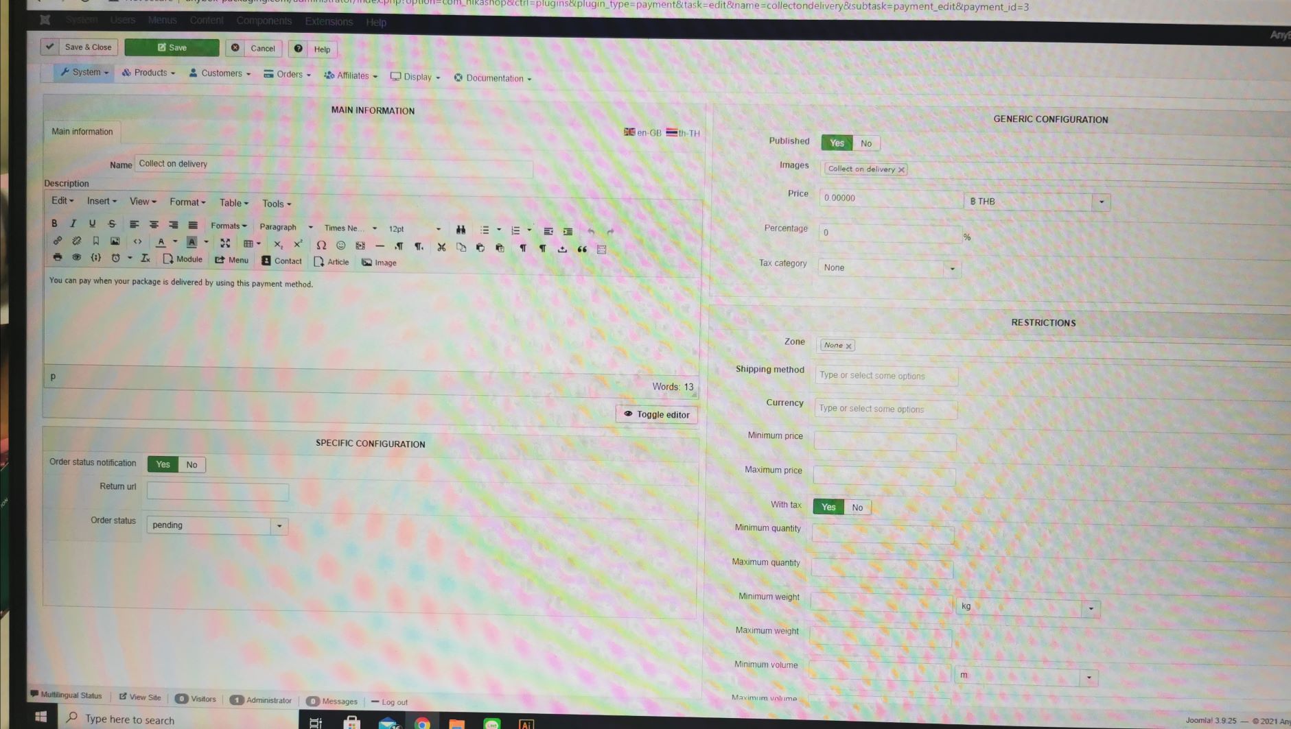

  • Posts: 10
5 years 4 months ago #331035

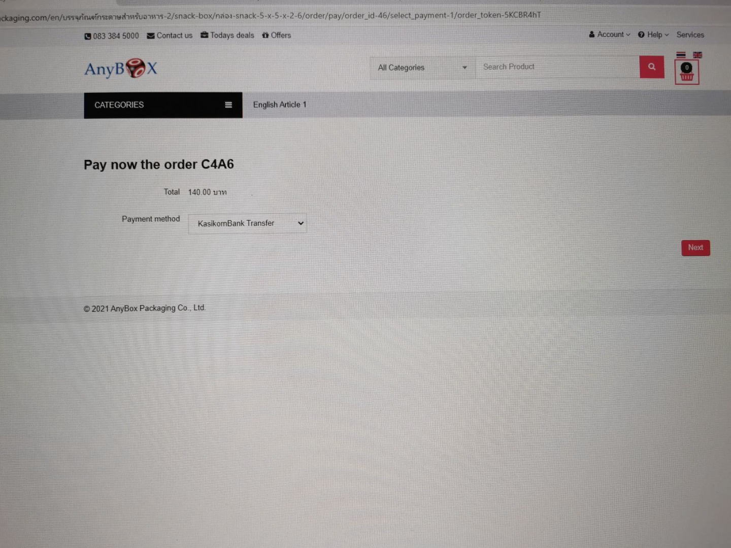

Many thanks to your solution. Now I try to insert a link to a form ,for customer to upload a proof of payment, in this page (please see Pic 1.).
Page in Pic 1. come from click on "Pay now" Button in the page in Pic 2.
But I can not find where I can insert it.
Last edit: 5 years 4 months ago by Kittisak112.
  • Posts: 86027
  • Thank you received: 14171
5 years 4 months ago #331049
You can use a translation override for that:
For example, if oyu search for the text "You can now transfer " in the HikaShop language file, you'll see that it's done with the line:
PLEASE_TRANSFERT_MONEY="You can now transfer the amount of %s using the following information."
Then, you could have an override with that to add your link:
PLEASE_TRANSFERT_MONEY="You can now transfer the amount of %s using the following information and then <a href='URL_TO_FORM'>send us your proof of payment here</a>."
where you can just replace URL_TO_FORM by the URL of your form page.
