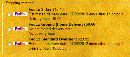

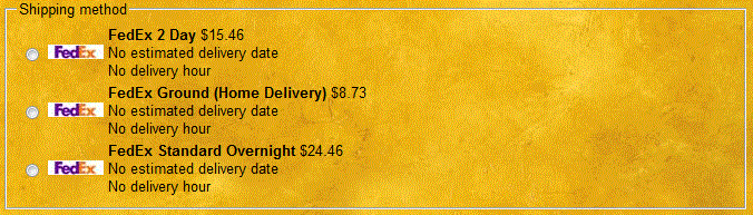

  • Posts: 22
14 years 2 months ago #55880
Jerome,
I installed the latest version and tried out the different ETA options and got the same results each time. "No estimated delivery date
No delivery hour".
Please see attachment.
Thanks,

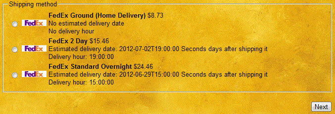

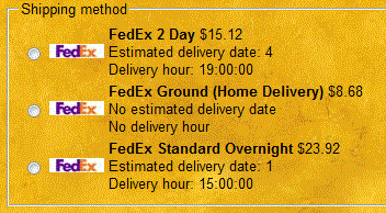

  • Posts: 22
14 years 2 months ago #56326
Hello Mohamed,
Please see attached screen captures for "Show ETA" and "Show ETA Delay"
Thanks,

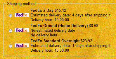

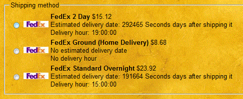

  • Posts: 22
14 years 2 months ago #56550
Hello Mohamed,
Please see attached.
Thanks,

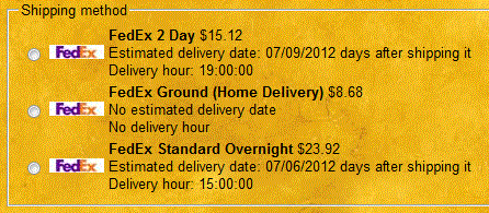

  • Posts: 22
14 years 2 months ago #56562
I updated my English Translation file, but got the exact same results as posted above.

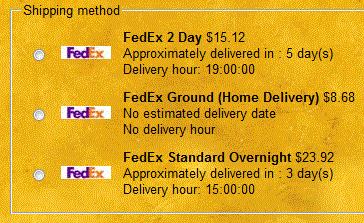

14 years 2 months ago #56641
Hi Sammsui,
Can you now change the last translation line by :
SHIPPING_DELIVERY_DELAY="Approximately delivered in : %s day(s)"

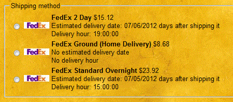

  • Posts: 22
14 years 2 months ago #56656
Mohamed,
I changed the line as you requested. Please see attachment below.
Might I suggest a slightly better translation: SHIPPING_DELIVERY_DELAY="Delivered in approximately: %s day(s)"

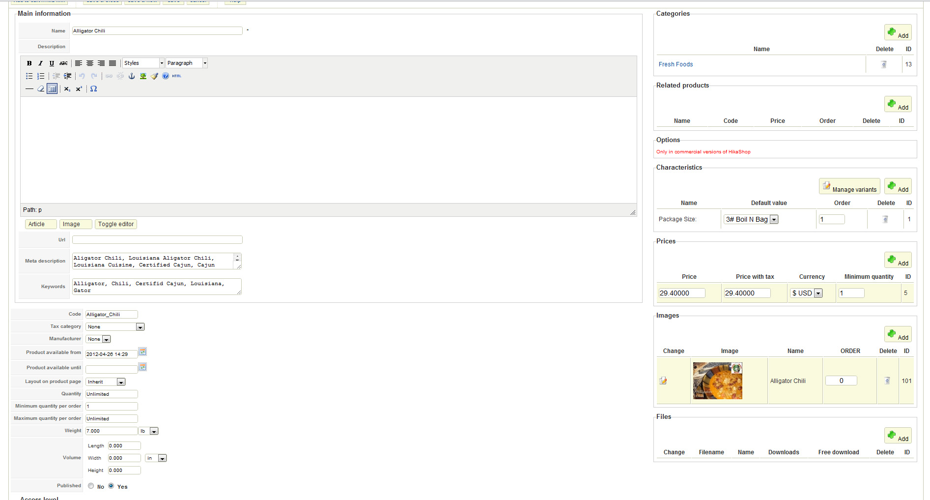

  • Posts: 15
14 years 1 month ago #58214
Screenshots are included of the fedex settings and a product. My site isnt currently live, so Ill have to give you access to the site with a user account that I set up for you. Ill send it to you in a PM. Manual Shipping in now disabled.
