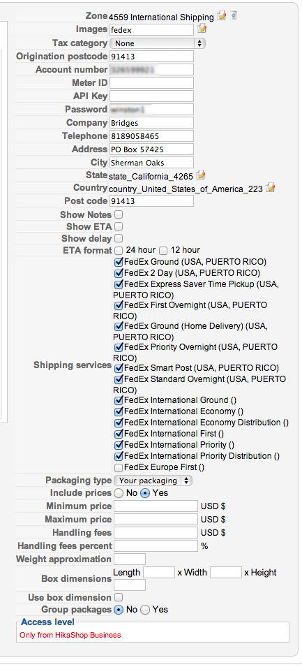

Hi, I updated hika to 2.0 and now the plugin has a save button again.
However, I still get the error:
FEDEX Authentication Failed
No shipping method found
Can you please look at my screen shot and see if there's something missing? According to fedex, they don't use API Key anymore.

"FEDEX Authentication Failed" means that the authentication information (account number, meter id, api key, password) is incorrect or partly missing.
Here is a link which clearly explain what each of these fields are for:
kb.modularmerchant.com/fedex-integration-a669.php
I can see that your meter id field is empty which should not be the case. Regarding the api key/password, I'm not sure but what I can say is that we didn't do any certification process with FedEx.

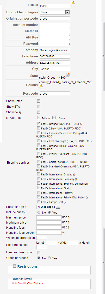

my fedex plugin only shows up on lighter products. started another thread but i think this is the place it should be. site is globalenginesales.com
shipping method fedex shows up on the engine heads that are like 20-50 pounds but if you put an engine in the cart thats 250-350 pounds i get no shipping method found. cant get ups to show on any product either. though i'm guessing there's a ups plugin thread i should go find. i could really use some help i'm supposed to be at work with this working tomorrow morning. i'm freaking out.

13 years 6 months ago #89959
if someone could look at my settings i'd love ya forever :woohoo: been mucking with this all week and i'm all out of ideas :(
