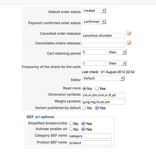

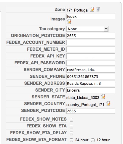

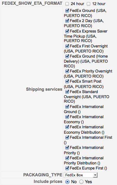

Also, if you could do a screenshot of your fedex shipping options and check that you have a weight and dimensions in your products in the same unit as the one in the fexed plugin and as the main unit of the configuration (the main one is the first one of the list of units) that would help.
  • Posts: 5
13 years 11 months ago #59566
screenshots attached... I believe all the settings are correct, but still getting the "no shipping methods" error... On the screenshots I've clared all the private details... fedex key, etc

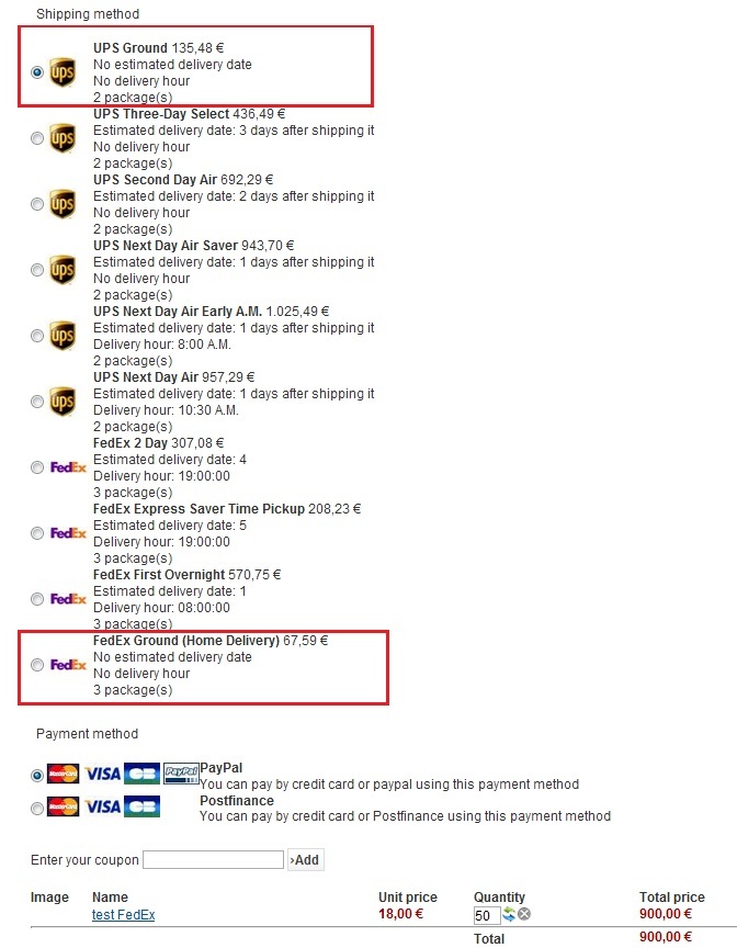

I'm using the latest version of the FedEx plugin and the rate calculation higher than it should be. I had a similar issue with the UPS plugin and you guys fixed it for us. I put some items in the cart and UPS returns a rate of 98.00 and FedEx returns 1000.00

Screenshot of the cart page with address and rates for 1 product, qty 50: www.diigo.com/item/image/1i0hc/3swi

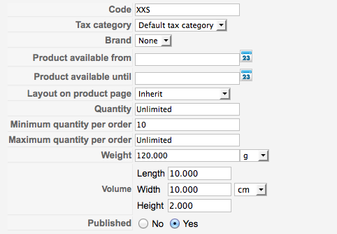

Screenshot of the product settings weight 3.5oz, dimensions 2.5in x 2.5in x 3in: www.diigo.com/item/image/1i0hc/v40t

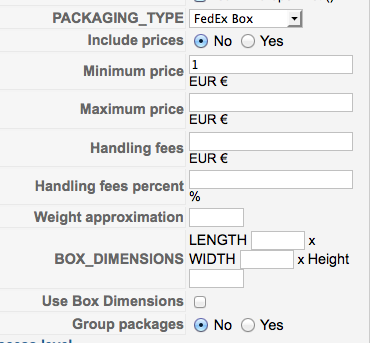

FedEx settings screenshot: www.diigo.com/item/image/1i0hc/cina

I've done a simple test with 1 product, qty 50 :
- product setting : weight 3.5oz, dimensions 2.5in x 2.5in x 3in.
- shipping method with same origination address and group package option turned ON.
And my FedEx rates are not highter than my UPS rates so I'll maybe understand were the problem come from with your screenshots.
