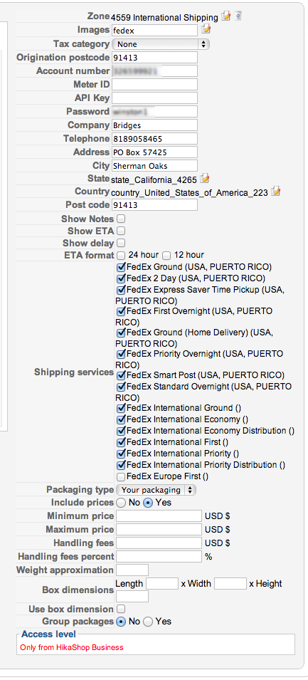

Trying to get the fedex plugin to work. I don't get any shipping rates and get the following error:
FEDEX Authentication Failed
No shipping method found
It doesn't work with or without a shiping zone defined.

Hi hsv,
1. Can you send me a screenshot of your FedEx shipping method configuration ?
2. Can you test it with the last versoin of the FedEx shipping method ?

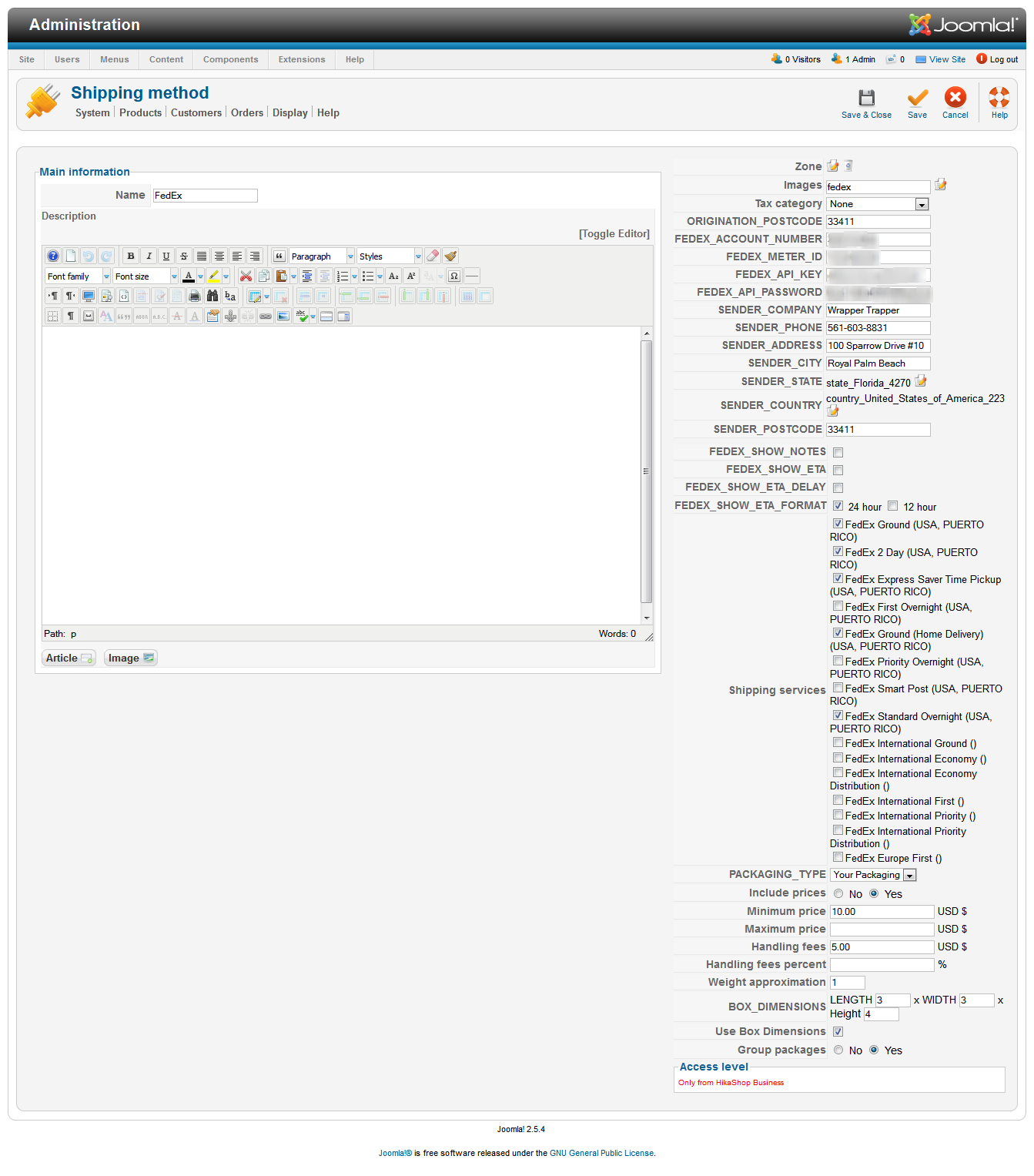

13 years 8 months ago #75952
Hi, I installed the latest version and now I get an error message when I try to edit the plugin:
500 - An error has occurred.
JHtml: :hikaselect not supported. File not found.
Also, I attached the screen shot of the fedex plugin. Unfortunately, now I can't see that screen due to the above error
Last edit: 13 years 8 months ago by hsv.
