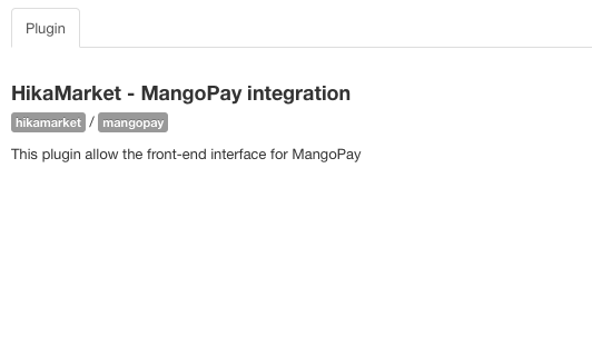

When you edit the "mangopay" payment method
After that, there is a second mangopay plugin in the group "hikamarket".
It means that the first "mangopay" plugin is not in the group "hikamarket" but in the group "hikashoppayment".
You're editing the wrong one.

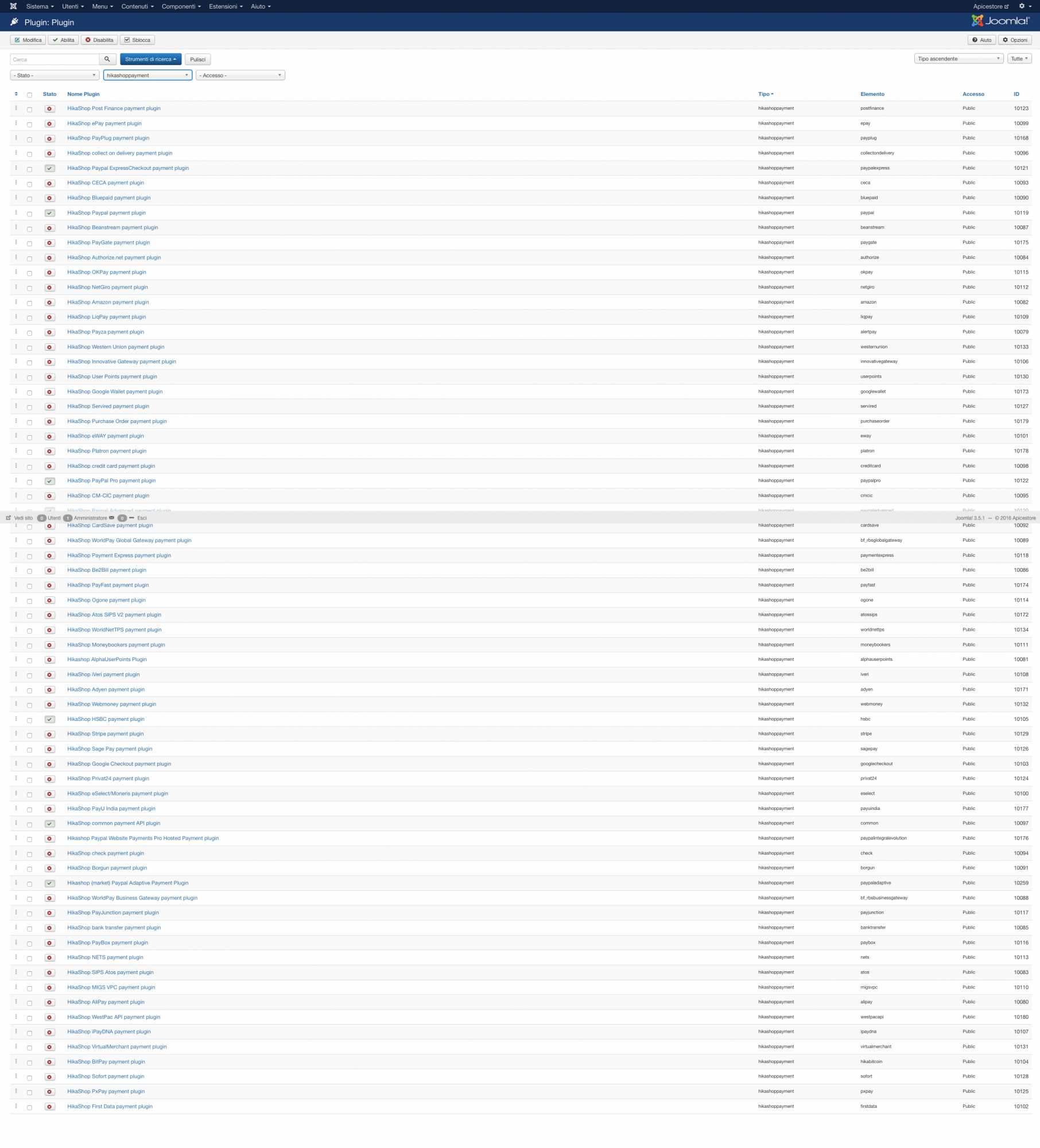

Did you configure the plugin "hikashoppayment / mangopay" in the Joomla plugin manager ?
  • Posts: 121
10 years 4 months ago #238748
no beacouse I havent Mango pay on my Joomla Plugin.

In a previous message, you provided a screenshot of the plugin "hikamarket / mangopay".
Sincerely, I don't understand how you can have one plugin and not the other and how you can have one of the plugin when you're using an old version of HikaMarket which do not include these plugins.
