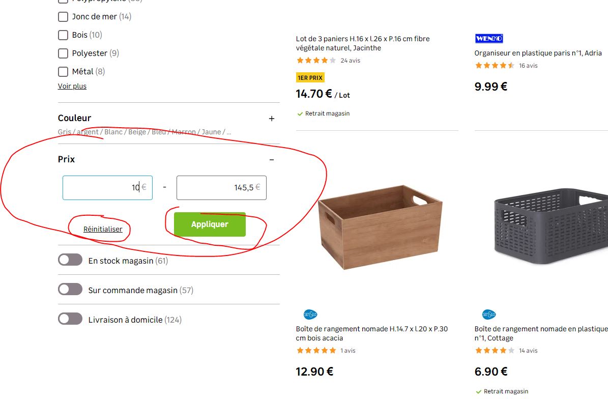

I also have another question that seems essential to me concerning a filter on the prices of a list of products:
after the user has made an adjustment on the price filter, how can we reset the filter?
I did not see this parameter in the creation of the filter?
so that we understand each other, I'll put a link: on this site, we can adjust the price filter, and then reset :
https://www.leroymerlin.fr/produits/salle-de-bains/accessoires-de-meuble-de-salle-de-bains/boite-de-rangement-de-salle-de-bains/

3/ the user can reset the filter: i.e. delete the filter he had chosen
(so that we understand each other, I'll put a link: on this site, we can adjust the price filter, and then reset :)
www.leroymerlin.fr/produits/salle-de-bai...t-de-salle-de-bains/

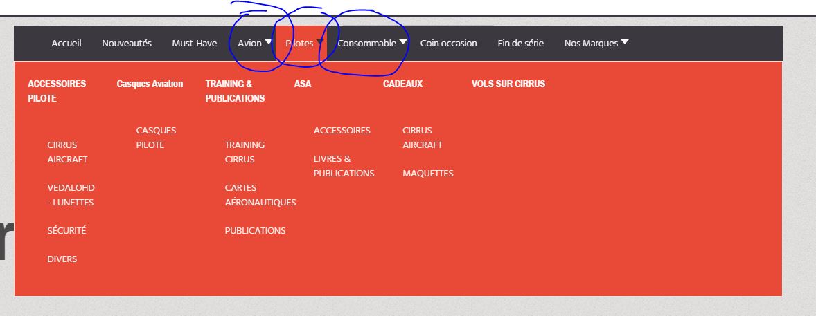

Here are the pages that have this problem: these are the child pages of the 3 tabs :
Avion, Pilotes, Consommables
Example: Avion/ACCESSOIRES AVION / CIRRUS AIRCRAFT
https://dev.aerolithe.fr/fr/categories-de-la-boutique/categorie/157-cirrus
