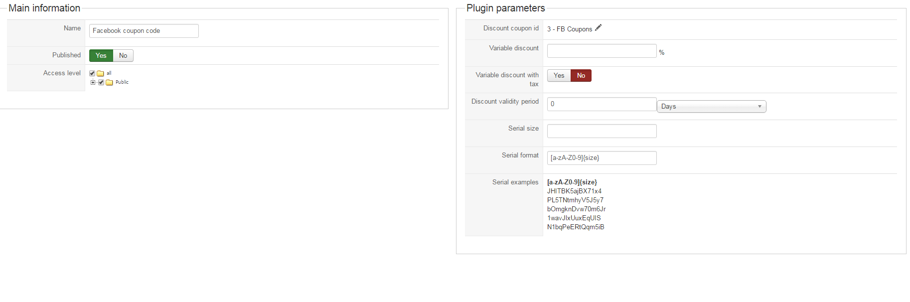

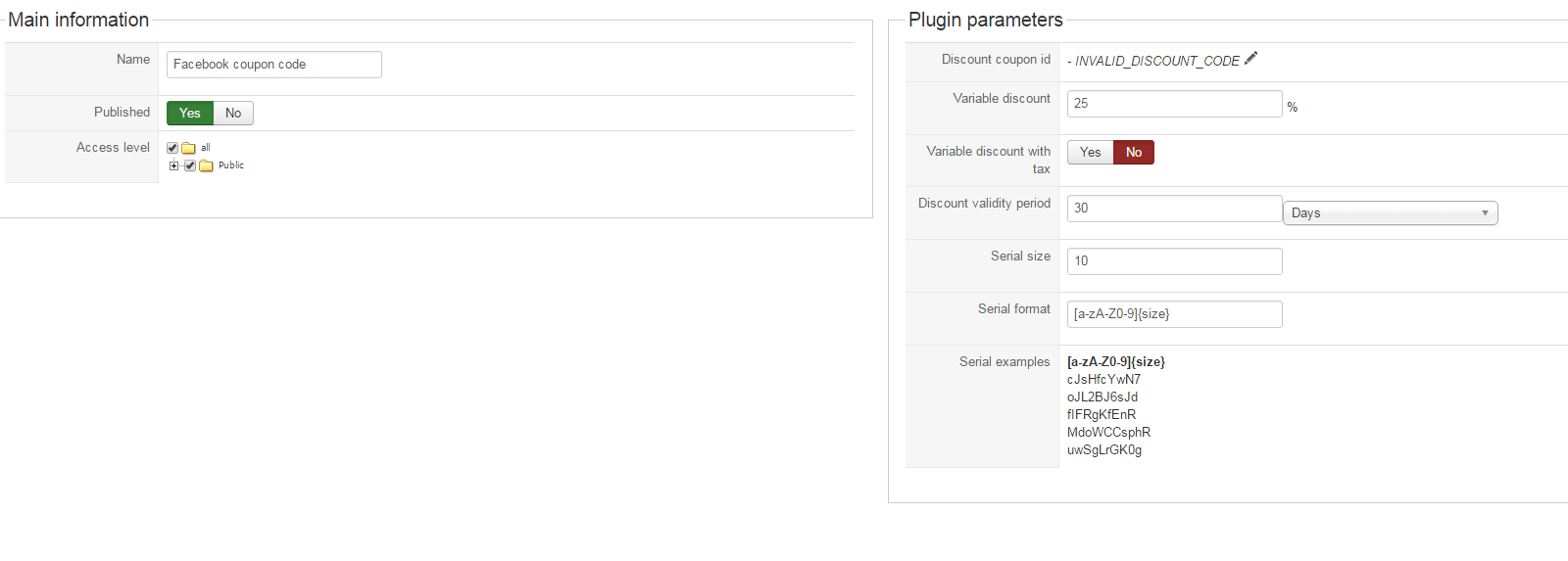

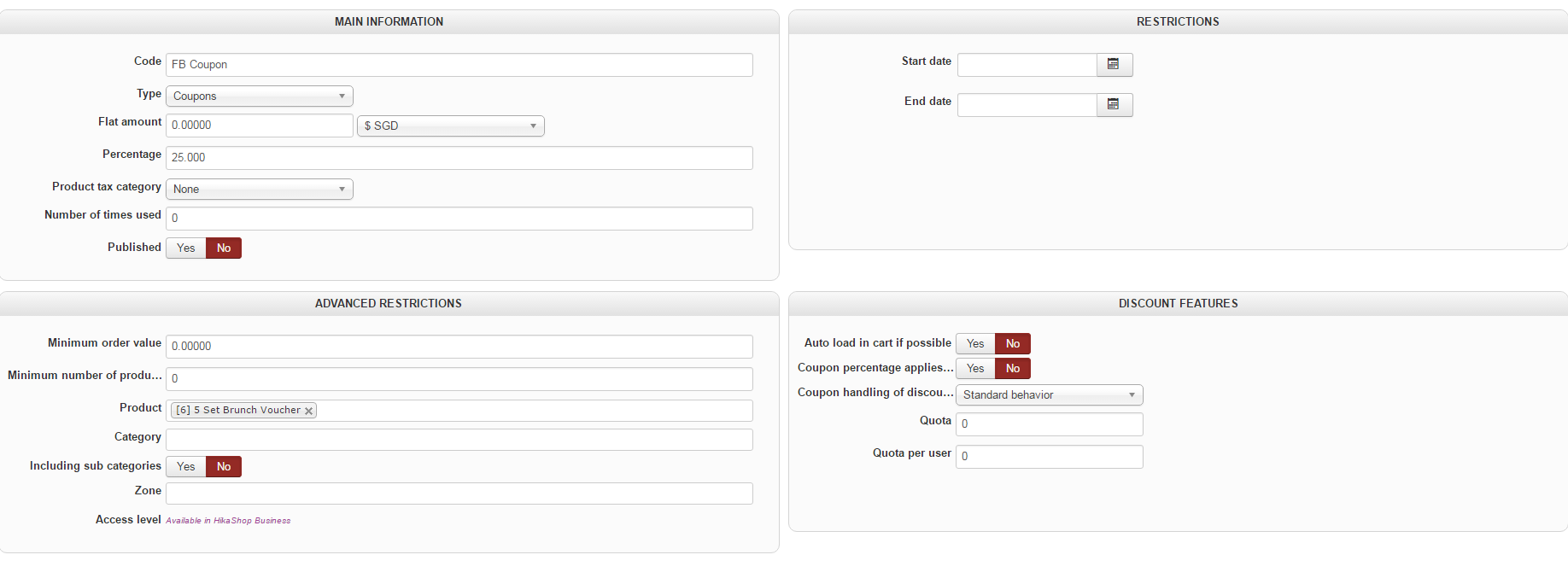

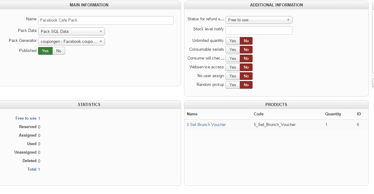

Following the tutorial I have creating the pack and associate it with a product. Creating the Coupon Generator as well, and the coupon template. (pls see attached images) How do they all work together to generate the serials/coupons I can give out to the customers offline? I don't see any list of serials generated anywhere I can use.
  • Posts: 26381
9 years 4 months ago #266254
CF : www.hikashop.com/support/documentation/1...ugins-coupongen.html
Your coupon generator configuration is not right.
- You did not select the coupon template
- You put a variable discount (depending the product price) while that's not what you want.
But fixing these two elements, HikaSerial should then generate coupons in the same time as the serials.

9 years 4 months ago #266449
You'll need to edit your coupon template in order to configure a quota ; it will be better for the usage at the end.

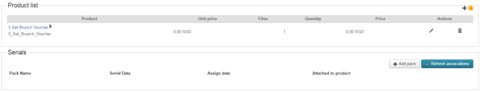

9 years 4 months ago #266528
I've created an order at the backend and the order is not "confirmed" and clicked on the "refresh associations" button as well, but no serials or coupons came out at the coupon listing. Can you check my backend? I think it can save us alot of time going back and forth like this.
Furthermore, I thought this hikaserial plugin can auto generate coupons at the backend without the need to create an order. So each time I need a coupon to use I need to create an order?
  • Posts: 26381
9 years 4 months ago #266559
If your order is not confirmed, you cannot have serials.
Please read carefully my previous message and that setting in the documentation page :
www.hikashop.com/support/documentation/1...nable_order_statuses
