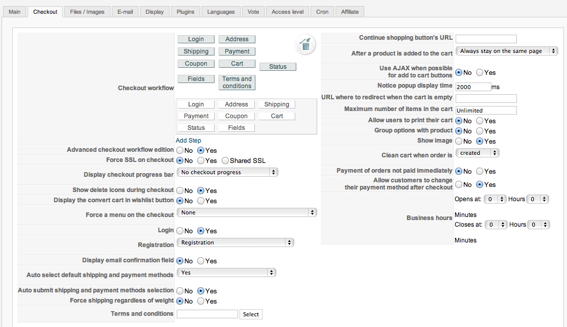

I have HikaShop 1.6.0.
I have attached a screen shot of the Checkout configuration page.
Let me know if you have any thoughts on this.
Thanks.

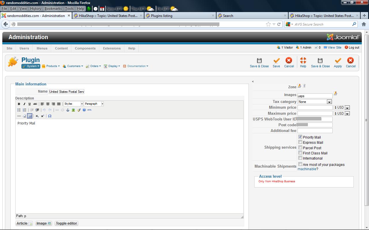

  • Posts: 5
13 years 10 months ago #76780
I've gone through the FAQs, and double checked my product dimensions and weights. I did add the manual shipping option, set for pick up? I only want to use USPS Priority Mail, and pickup for locals. Still no shipping option. I've attached the screenshot of the USPS plugin page. I know I must be missing something...
~Lynda
  • Posts: 26386
  • Thank you received: 4078
13 years 10 months ago #77051
USPS check the shipping_address of the order and the "Priority mail" just display when
$order->shipping_address_full->shipping_address->address_country->zone_code_2 == 'US'
Otherwise, it ask for "International" option.
Can you please check it ?
