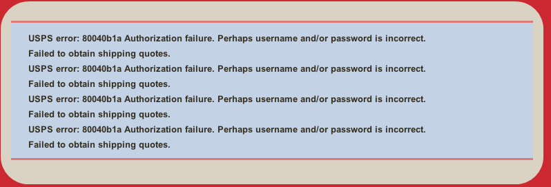

I am getting the same USPS error below multiple times upon checkout. I have verified that my USPS user is on the production server. It is calculating the prices correctly, yet still displaying the error.
USPS error: 80040b1a Authorization failure. Perhaps username and/or password is incorrect.
Failed to obtain shipping quotes.

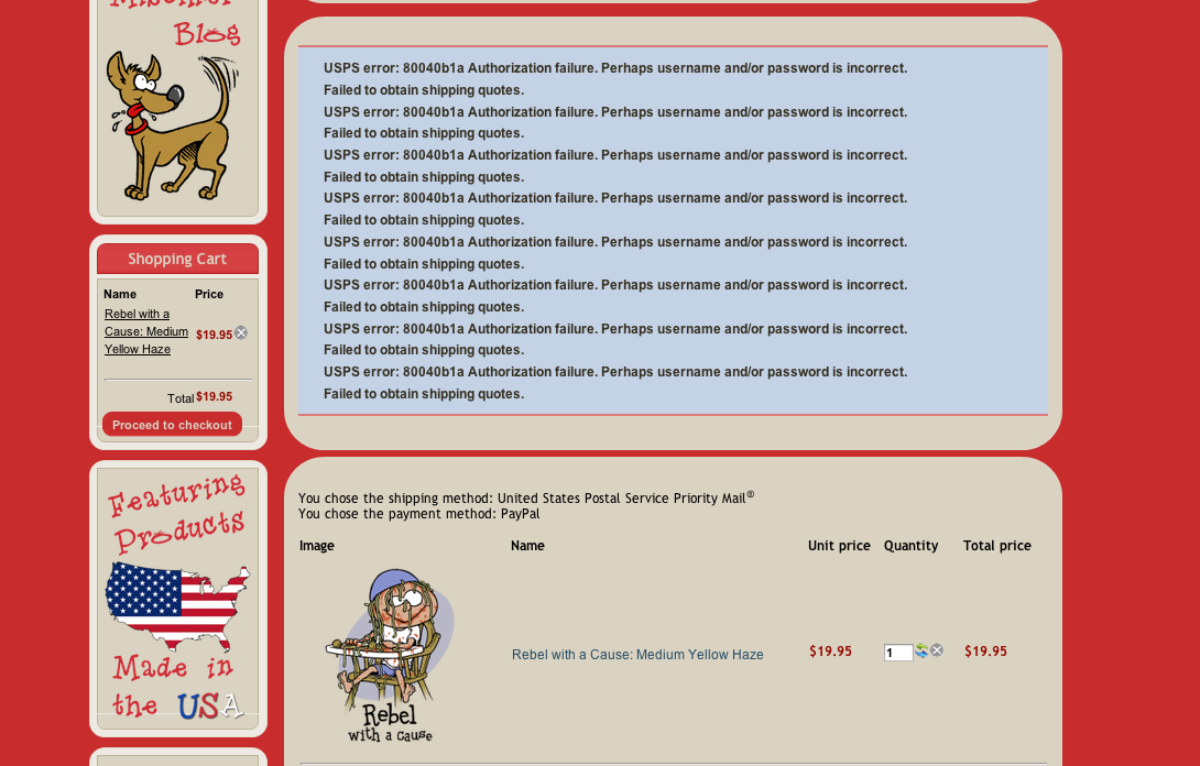

I have verification from USPS that we are on the production server. Please check the last message I sent you with the details. Are you not seeing these error codes when you go to checkout? I am seeing the same 80040b1a code multiple times when I checkout. However the correct shipping amounts are being received from the USPS api

It happens everytime you proceed through checkout using a USA address. Please let me know if you have any other suggestions. At this point we will have to stop using Hikashop

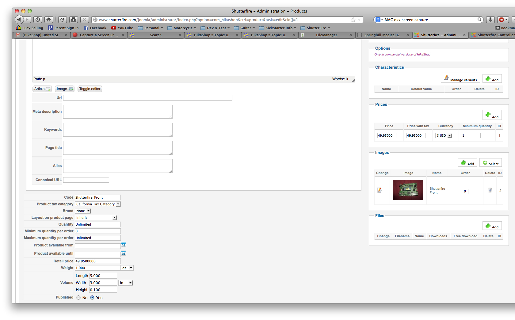

I swear I've looked the documentation and searched the forums but couldn't find an answer. It seems like it should be simple but...
I get this error - THE_CART_ITEMS_COMBINED_QUANTITY_IS_TOO_HIGH_FOR_ALL_THE_POSSIBLE_SHIPPING_METHODS - no matter how much I play around with quantity. In the Product screen I've set it from 0 to Unlimited, left them blank.
I've turned on and off price per product (and played with various combinations of settings, as well).
I've copied the United States of America zone and the new one is a shipping zone.
There's nowhere in the Shipping method to set quantity.
I've tried no zone in the method, the included zone for US above, and my shipping zone copy.
I've created a manual method that should cover shipping in the US. The per product plug-in is enabled (in fact I had some manual methods working but they weren't precise enough.
Any help would be appreciated, I just can't see where to change the quantities except in the product page.
Mark

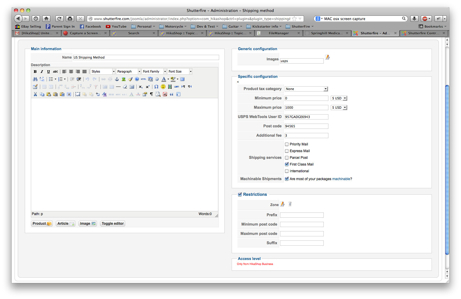

13 years 2 months ago #113916
1. Can you show me screenshots of how did you configured :
- Your product
- Your shipping method
2. Can you give me a link to your website then I'll be able to see what shipping methods your exactly using and to reproduce your problem.
Thanks.
  • Posts: 25
13 years 2 months ago #113948
Mohammed,
Thanks for the reply.
See the attached.
Mark

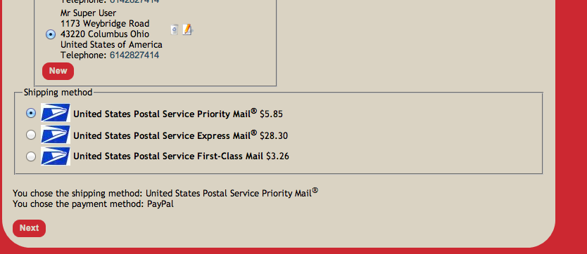

The new version seems to have fixed the paypal problem. There's still a limit on the number of items per order but I don't see any error message anymore, the shipping method simply isn't available. The paypal problem was the biggest obstacle, but I'd like to see quantity working as well.
13 years 2 months ago #114287
I've done some tests, and it seems like your shipping methods are actually available, and are displaying through the checkout. Did you solved the problem ?
