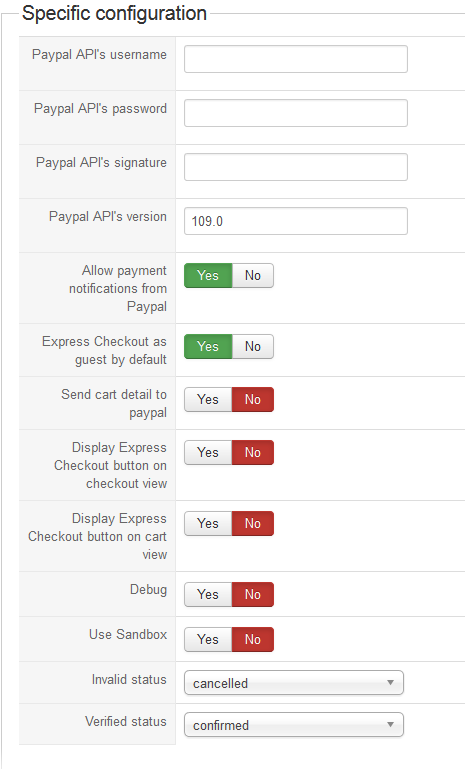

Additional Information
- API username : Enter here the API Identifier associated to your Paypal account.
- API Password : Enter here the API password associated to your Paypal account.
- API Signature : Enter here the API signature associated to your Paypal account.
- API version : You can change the API version if required.
- Allow payment notification from paypal : That option should stay on unless you don't want that PayPal confirms automatically the orders on your website so that you can do it manually yourself.
- Express Checkout as guest by default : Display or not the paypal landing page for the paypal login.
- Send cart detail to paypal : Send the detail of the products to paypal
- Display Express Checkout button on checkout view : Display the paypal express checkout button during the checkout
- Display Express Checkout button on cart view : Display the paypal express checkout button under the cart module
- Sandbox : You can activate the sandbox mode of the payment plugin. If you do so, all transactions will be done through the Paypal's sandbox system, and no real money will be used.
- Debug : You can activate the debug mode of the payment plugin. If you do so, informations about each notification received from Paypal will be logged in the payment log file. You can see and modify the location of this file in the configuration page of HikaShop.
- Invalid status : Here, you can select the status to set to an order if the plugin receives a notification from Paypal for an order with an amount different from the order total or in a different currency. In that case, we highly recommend you to check your Stripe account, the order information, and maybe contact your customer, and decide yourself what to do with the order.
- Verified status : Here, you can select the status to set to an order if the plugin receives a successful completion notification from Paypal for an order.
