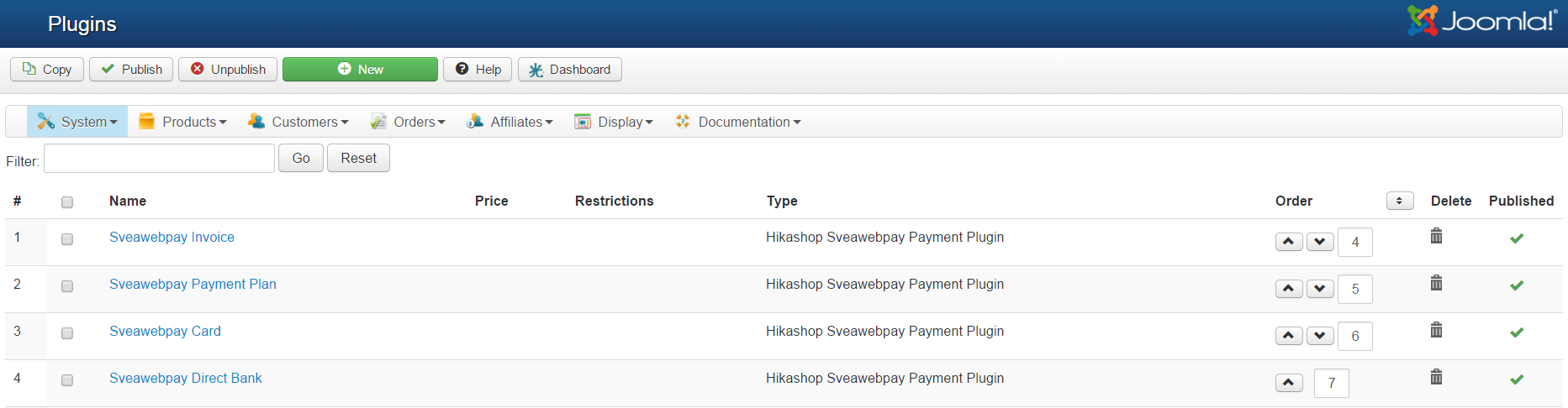

Note : If you have to use several of these 4 modes, you have will have to create several instances of that payment plugin and in each one, you'll need to fill in the identification information relative to that payment mode. Some could be different and some are identical from each mode, so beware which references are required.

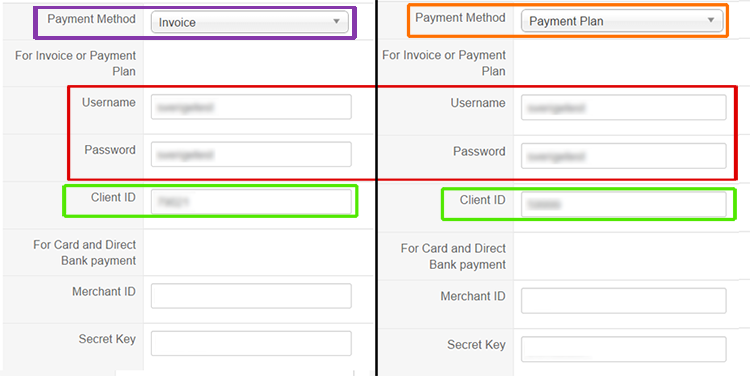

Required For Invoice and Payment Plan
The Invoice and Payment Plan Modes require you to fill the same inputs : "Username" and "Password", BUT, the "client ID" is different.
In red, it requires the same value, and in green, different values.
- USERNAME : Same Value for both modes.
 - PASSWORD : Same Value for both modes.
 - CLIENT ID : Differents !

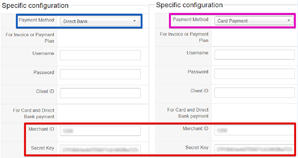

Required For Direct Bank and Card Payment.
The Direct Bank and Card Payment Modes require you to fill the same inputs : "Merchant ID" and "Secret Key".
- Merchant ID : Same Value for both modes.
 - Secret Key : Same Value for both modes.

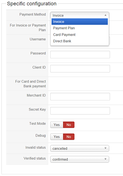

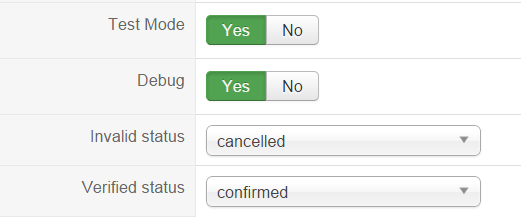

The different options:
All these options are common to All modes.
- Test Mode : You can choose here to switch between test mode (without real transactions) and production mode.
 - Debug : Here, you can set the debug mode, which means that each payment or test will add information in the payment log file in order to help you see sent and received data in the Files section of the configuration page of HikaShop.
 - Invalid Status : The aim of this option is to choose which status will be set for an invalid payment notification from the svea Webpay platform.
 - Verified Status : Same idea than above, but for a verified payment notification from the Svea Webpay platform.
Help : If you don't know anything about the payment log, go here.
Note : In Test Mode, your products must cost at least 1000 SEK in order to test the Svea Webpay platform.

First, select your mode in the Payment Method dropbox.

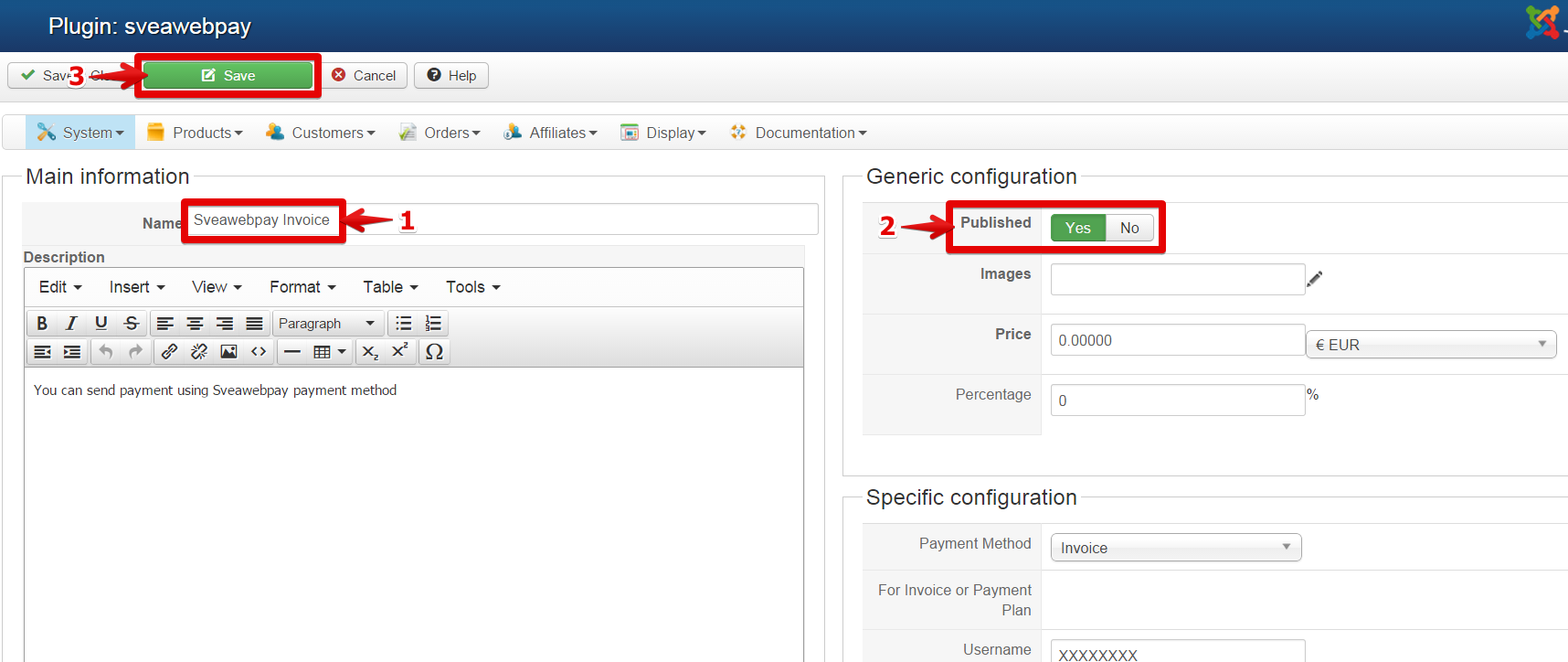

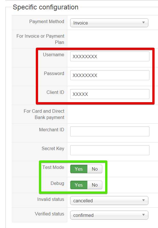

Then, fill the required identification fields for the selected Payment Method (here : Invoice), and if it's the first time, we recommend the Test Mode AND the Debug options, so switch them to "Yes".
Don't forget to click on published AND to save !
- Add a name to your Payment Method Configuration.
 - Click on "Yes" to published this method.
 - Save.
Note : If you want use several Svea Webpay Payment Methods, create several Svea Webpay payment instances like on the screen below.

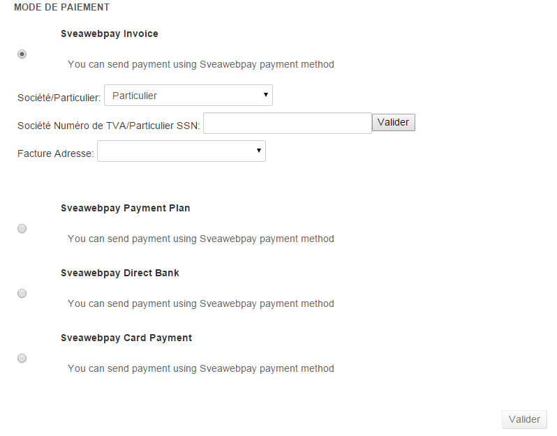

View on the Checkout
We can see on the Checkout page all the methods published, so the customer may choose one payment mode and fill if required, his SSN code/VAT number
Note : The SSN code/VAT number is asked to the customer for the Invoice and the Payment Plan modes, for the Direct Bank and the Card payment modes the customer will be redirected to the payment platform website after finishing the checkout.
