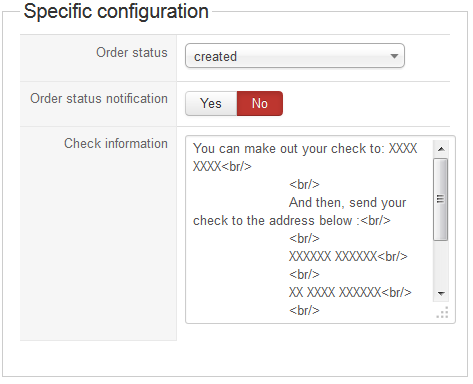

- Order status : As HikaShop cannot know when the payment is accepted by your bank and credied on your account, you will have to set the appropriate status after checking you bank account. In the mean time, you have the possible to set to the order another status than the one that you can configure in the configuration page. For example, you could create a status "pending" and use it here instead of the "created" status which is set by default to any order created.
- Order status notification : If activated and that you select another order status than "created" in the option above, the user will receive both the order creation notification (sent when the order is created) and the order status notification (usually sent when the order is confirmed).
- Return URL : Enter here the URL where you want the customer to be redirected at the end of the checkout if he chose that payment method. If left blank, it will display the default thank you page with the check payment information.
- Check information :Here, you need to write your check details (name of your company and address to send the check) so that your users will be able to send you the check. You can of course, write anything you want, the default text is just an example of how you might want to do it.
