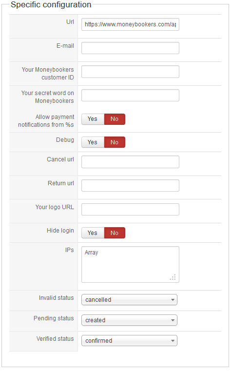

moneybooker
Additional Information
  • Currency: Choose the currencies allowed by this payment method.
  • Moneybookers url : The url to which your users are redirected to for the payment. This should not be changed unless you know what you are doing.
  • Your Moneybookers email address : The email you used to register your Moneybookers account on which you will receive the payments from your customers.
  • Your Moneybookers customer ID : The customer ID Moneybookers attributed to you when you registered.
  • Your secret word on Moneybookers : The secret word is used as a security measure to validated payment notifications coming from Moneybookers. You need to set the same lowercase, less than 10 characters string here and in the moneybookers merchant tools interface.
  • Allow payment notifications from Moneybookers : If set to yes, the plugin will handle the Skrill (Moneybookers) payment notifications and automatically validate the orders after checking that the notification is valid.
  • Debug : You can activate the debug mode of the Skrill (Moneybookers) payment plugin. If you do so, informations about each notification received from Skrill (Moneybookers) will be logged in the payment log file. You can see and modify the location of this file in the configuration page of HikaShop.
  • Cancel url : The url you want your users to be redirected to when they cancel the order from the Skrill (Moneybookers) interface. By default, they will be redirected to the first step of the checkout process.
  • Return url : The url you want your users to be redirected to when they finish their payment on the Skrill (Moneybookers) interface. By default, they will be redirected to the after_end page of the checkout process which will thank them for their order.
  • Your logo url on Moneybookers : You can set here an url for a banner image which will be displayed on top of the payment page on Skrill (Moneybookers).
  • Hide login : If activated, the Skrill (Moneybookers) login form is hidden on the payment page so that the customers directly pay by card or with the other methods.
  • Moneybookers IPs : A list of IPs from which notifications will be processed. It doesn't mean that notifications coming from those IPs are validated automatically. All notifications are automatically validated through a fingerprint validation using your secret word to ensure that the notifications comes from Moneybookers. This is just an additional security measure. Moneybookers might change or add IPs without notification. When your server receives a notification from another IP than those, you will receive an email automatically to your payment notification address informing you. If you are sure that the IP from which the notification came from is a valid Moneybookers IP you can add it to the list manually. If the notification came from someone else, it might be an attack attempt (if the payment has not been received on your Moneybookers account for instance), in which case you can ignore it as the system blocked it. Finally, you can always disable this feature by removing all the IPs in the list and saving the Moneybookers payment method options. You will always be able to reactivate the feature.
  • Invalid status : Here, you can select the status to set to an order if the plugin receives a notification from Skrill (Moneybookers) for an order with an amount different from the order total or in a different currency. In that case, we highly recommend you to check your Skrill (Moneybookers) account, the order information, and maybe contact your customer, and decide yourself what to do with the order.
  • Pending status : Here, you can select the status to set to an order if the plugin receives a pending notification from Skrill (Moneybookers) for an order. A pending notification means that the customer entered his payment information but that Skrill (Moneybookers) could not yet receive the funds. In that case, we highly recommend you to check your Skrill (Moneybookers) account, the order information, and maybe contact your customer, and decide yourself what to do with the order.
  • Verified status : Here, you can select the status to set to an order if the plugin receives a successful completion notification from Skrill (Moneybookers) for an order.
