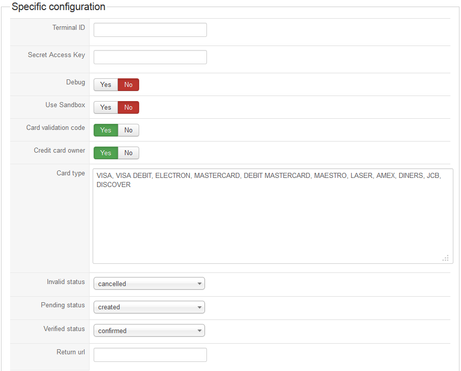

worldnet
Additional Information
Please note that the WorldNetTPS payment plugin uses the XML integration and WorldNetTPS. As such, the credit card information of the customer is asked during the checkout on your website. We highly recommend the use of a SSL certificate on your website in such case.
  • Terminal ID: The merchant id corresponding to your Worldnet account.
  • Secret access key: The secret key you have to configure on your Worldnet account (Settings > User).
  • Use sandbox: To activate the test mode : all transactions will be done on the Worldnet test plateform.
  • Debug : You can activate the debug mode of the payment plugin. If you do so, informations about each notification received from Wolrdnet will be logged in the payment log file. You can see and modify the location of this file in the configuration page of HikaShop.
  • Card validation code: If you activate this setting, the credit card validation code will be asked at the same time that other credit card's information, during your payment process.
  • Crédit card owner: If you active this setting, the credit card owner's name will be asked at the same time that other credit card's information, during your payment process.
  • Card type: Enter here the different card type you accept to proceed to a payment. The different types have to be written with capital letters, and separated with commas without any space.
  • Invalid status : Here, you can select the status to set to an order if the plugin receives a notification from paypal for an order with an amount different from the order total or in a different currency. In that case, we highly recommend you to check your Worldnet account, the order information, and maybe contact your customer, and decide yourself what to do with the order.
  • Verified status : Here, you can select the status to set to an order if the plugin receives a successful completion notification from Worldnet for an order.
