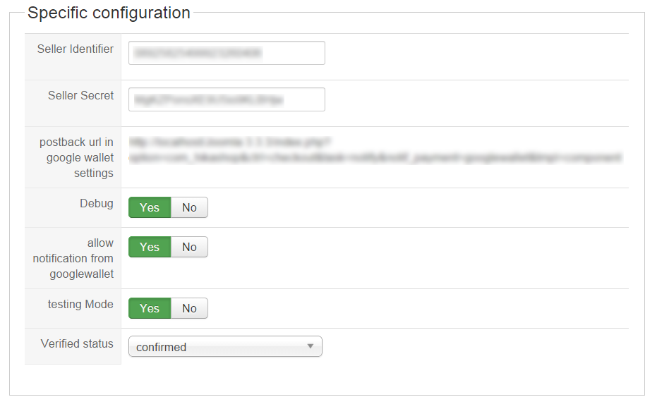

- In this part, we will see the primordial options of the Google Wallet payment method. The only things you will need are your Seller Identifier and your Seller Secret.
 - Seller Identifier : Just put your Seller Identifier in this field. This identifier is given by Google Wallet.
 - Seller Secret : Just put your Seller Secret in this field. This code is given by Google Wallet.
 - postback url in google wallet settings : Use this Postback Url in the Google Wallet Setting Page.
NOTE: If you want to know more about these Google Wallet settings, you can look at the step by step sandbox setting page.
The different options:
- Debug : You can here enable the debug option of the API. Don't enable this one if you don't have to look into the API's configuration
 - Allow payment notifications from Google Wallet : If this option is enable, the automatic response of Google Wallet server will be treated to update the order status. For example, if the payment has been completed correctly, the order status will be the specified verified status.
 - Testing Mode : You can choose here to switch in test mode (for use the Google Wallet sandbox) or in production phase.
 - Verified status : Here, you can select the status to set to an order if the plugin receives a successful completion notification from Google Wallet for an order.

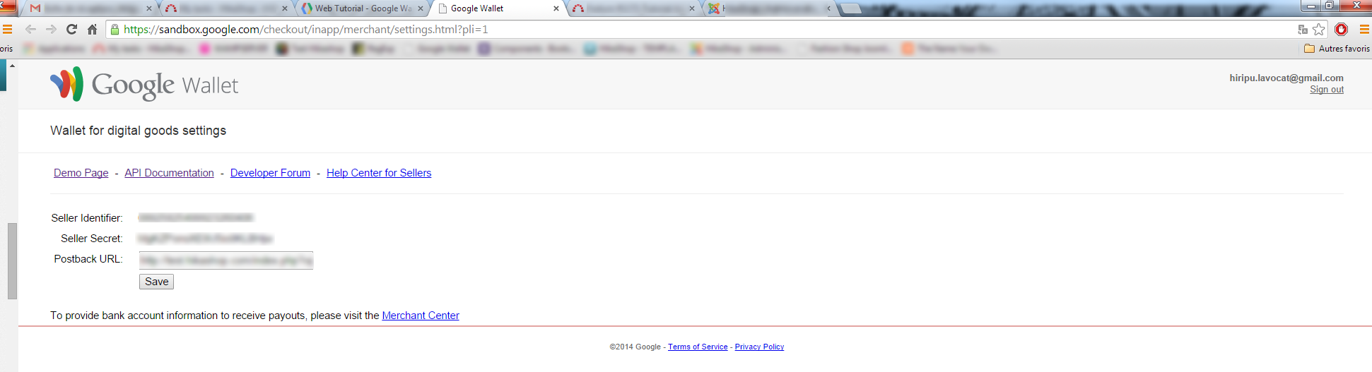

Step by step configuration
- In order to use the Google Wallet payment method, you have to possess some informations that Google Wallet should have given to you,your Seller Identifier and Seller Identifier, so you must create an account on Google Wallet to get this information and be able to reach your Google Wallet setting page.
 - After this, you have to enter your Seller Identifier and your seller secret in your Google Wallet Specific Congiguration.
 - Enter your Postback url (given in your Google Wallet Specific Configuration) in the Google Wallet sandbox setting page (in "Testing Mode") OR the Google Wallet Production setting page ( in "production phase").
 - Choose to switch on the testing mode OR not ("production phase") and your plugin will automatically send the needed data to the right Google Wallet page.

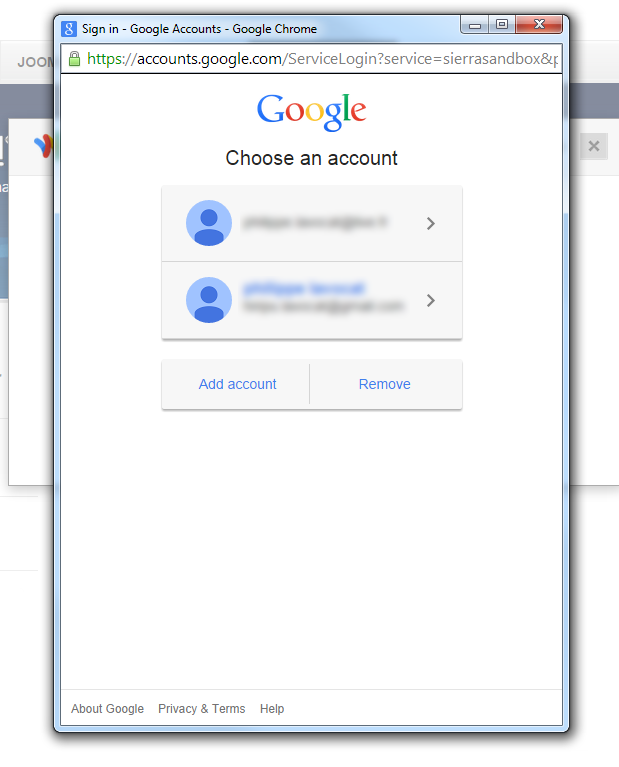

- Let's have a look just after the customer click on the finish button.
After the checkout, customers have to log in his Google Account.

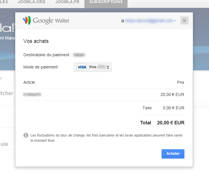

After this you should see the Google Wallet payment pop up window.
For the end of the operation
- If the status is validated by Google Wallet, Hikashop will save all the data and especially the order Id, if for some reason payment is refused by the Google Wallet Gate, the customer will recieve an Email about this canceled operation.
