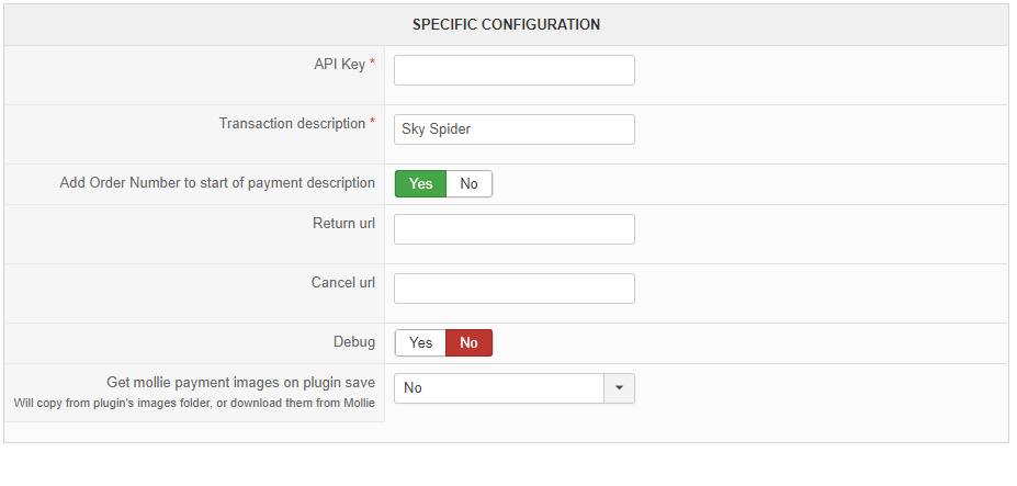

Additional Information
In this part, we will see the main options of the Mollie payment method.
  • API Key : either a Test key or Live key. Get your key from Mollie here
  • Transaction description : this will show up on the customer's bank statement. You should keep this short.
  • Add Order Number to start of payment description : will put the auto-generated HikaShop Order Number in front of the transaction description. E.g. "B1Z2 Sky Spider"
  • Return url : where you want the user returned to after a successful payment. Not required.
  • Cancel url : where you want the user returned to after a failed payment. Not required.
  • Debug : if you want certain information sent to the logfile.
  • Get mollie payment images on plugin save : if set, when you save the plugin options it will try and get Mollie payment method icons, either from the plugin folder or from mollie's website.
CAUTION : This references must be keep secret !
Note : While you process some tests or try to get clue with an issue in the Debug mode information will be added in the Log file.
Help : If you don't know anything about the payment log, go here.
