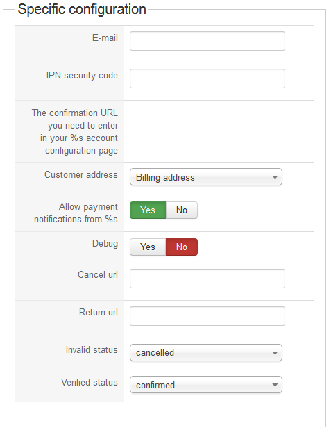

Additional Information
- E-mail : The email you used to register your AlertPay account on which you will receive the payments from your customers.
- IPN security code : You need to enter here the IPN security code given to you by AlertPay.
- The confirmation URL you need to enter in your AlertPay account configuration page : You need to do that so that AlertPay will send the payment notifications to HikaShop.
- Customer address : If you want, you have the possibility to include the billing or shipping address of your customers to the AlertPay payment engine. That will avoid them the hassle of reentering it on AlertPay if they don't already have a paypal account.
- Allow payment notifications from AlertPay: If set to yes, the plugin will handle the alertpay payment notifications and automatically validate the orders after checking that the notification is valid.
- Debug : You can activate the debug mode of the AlertPay payment plugin. If you do so, informations about each notification received from AlertPay will be logged in the payment log file. You can see and modify the location of this file in the configuration page of HikaShop
- Cancel url : The url you want your users to be redirected to when they cancel the order from the AlertPay interface. By default, they will be redirected to the first step of the checkout process.
- Return url : The url you want your users to be redirected to when they finish their payment on the AlertPay interface. By default, they will be redirected to the after_end page of the checkout process which will thank them for their order.
- Invalid status : Here, you can select the status to set to an order if the plugin receives a notification from AlertPay for an order for which the payment couldn't be validated. In that case, we highly recommend you to check your AlertPay account, the order information, and maybe contact your customer, and decide yourself what to do with the order.
- Verified status : Here, you can select the status to set to an order if the plugin receives a successful completion notification from AlertPay for an order.
