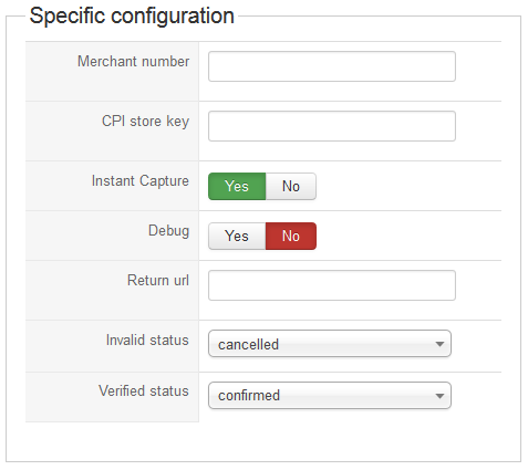

Additional Information
- Merchant number : The merchant number that HSBC should have given you. It's a 13-character string in the form of UK12345678CUR.
- CPI Store Key : Put here the Key Store you should have received from HSBC. This is a 32-character string with letters and figures.
- Instant Capture : You can choose here to validate the transaction automatically when the payment is done. If this option is not selected, you will have to validate manually every payment made on your website.
- Debug : You can activate the debug mode of the HSBC payment plugin. If you do so, informations about each notification received from HSBC will be logged in the payment log file. You can see and modify the location of this file in the configuration page of HikaShop
- Cancel url : The url you want your users to be redirected to when they cancel the order from the HSBC interface. By default, they will be redirected to the first step of the checkout process.
- Return url : The url you want your users to be redirected to when they finish their payment on the HSBC interface. By default, they will be redirected to the after_end page of the checkout process which will thank them for their order.
- Invalid status : Here, you can select the status to set to an order if the plugin receives a notification from HSBC for an order with an amount different from the order total or in a different currency. In that case, we highly recommend you to check your HSBC account, the order information, and maybe contact your customer, and decide yourself what to do with the order.
- Verified status : Here, you can select the status to set to an order if the plugin receives a successful completion notification from HSBC for an order.
