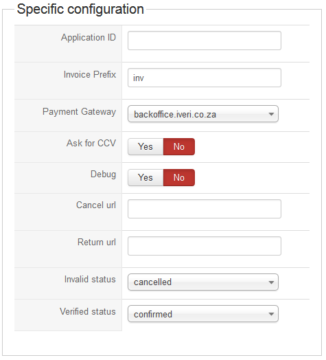

Please note that this payment plugin displays a credit card form directly during the checkout on your website. This means that your sales will be higher than with a redirection to the payment gateway, as there will be less steps to finish an order, however, it also means that you should purchase and configure a SSL certificate on your web server in order to handle the credit card information securely (that will add the security seal to your website).
iveri
Additional Information
  • Application ID : Your applicationID (given by iVeri).
  • Invoice Prefix : You can add a prefix to the invoice uid generated. It allow you to see immediately where the invoice is coming from. Default prefix is "inv". Here is an example of what your invoice will look like with this prefix: invF658330B-AC9C-492B-95E7-BFXXXXXXXXXXX.
  • Payment Gateway : You can choose here your payment Gateway (it depends of your location).
  • Ask for CCV : Choose here if the CVV have to be asked to customers during the transaction (CCV are the 3 digits you can find at the back of a credit card).
  • Debug : You can activate the debug mode of the Iveri payment plugin. If you do so, informations about each notification received from Iveri will be logged in the payment log file. You can see and modify the location of this file in the configuration page of HikaShop
  • Cancel url : The url you want your users to be redirected to when they cancel the order from the Iveri interface. By default, they will be redirected to the first step of the checkout process.
  • Return url : The url you want your users to be redirected to when they finish their payment on the Iveri interface. By default, they will be redirected to the after_end page of the checkout process which will thank them for their order.
  • Invalid status : Here, you can select the status to set to an order if the plugin receives a notification from Iveri for an order with an amount different from the order total or in a different currency. In that case, we highly recommend you to check your Iveri account, the order information, and maybe contact your customer, and decide yourself what to do with the order.
  • Verified status : Here, you can select the status to set to an order if the plugin receives a successful completion notification from Iveri for an order.
