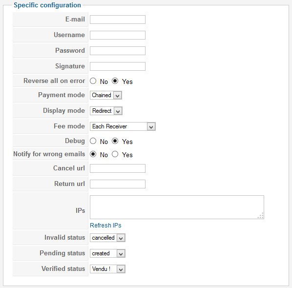

Additional Information
Additional information
  • E-mail : The email you used to register your paypal account on which you will receive the payments from your customers.
  • Paypal Classical : Use the classical mode (not the adaptive one) to override the used paypal email by the vendor email.
  • Username : The username given by paypal in order to use the "adaptive" api.
  • Password : The associated password for the username.
  • Signature : The signature key for your paypal account.
  • Application Id : The application ID for your paypal application (required only in "live")
  • Reverse all on error : Cancel all linked payemnts if one payment have an error.
  • Payment mode : You can specify of the linked payment will be Chained or Parallel. In chained payments, the customer will just see your paypal account.
  • Display mode: You can specify how the payment will be displayed.
    • Redirect : The customer will be redirected to the paypal website.
    • Popup : A popup with an iframe will be opened in your website.
  • Fee mode: You can specify how paypal fees are dispatched.
    • Each Receiver (default) : every receiver will pay the paypal fees depending to their total.
    • Sender : The customer will have to pay the paypal fees for the global payment.
    • Primary Receiver (only in chained mode) : Your account will pay all fees.
    • Secondary Receivers (only in chained mode) : Your account won't pay fees, the other accounts will.
  • Put store as secondary receiver : Your account will be noted as secondary receiver, so the vendor will be set as primary. Please use that setting with caution and be sure that your adaptive account is compatible with that setting.
  • Debug : You can activate the debug mode of the paypal payment plugin. If you do so, informations about each notification received from paypal will be logged in the payment log file. You can see and modify the location of this file in the configuration page of HikaShop.
  • Use sandbox : Use the paypal sandbox to perform tests.
  • Notify for wrong emails : If another receiver have a wrong paypal account, the plugin will change his configuration.
    You can be notified by email that a vendor paypal account is wrong. At this moment you will have to pay the account manually.
  • Use Raw sockets instead of cURL : the plugin can use cURL for communication with Paypal plateform. If you have issues with it (SSL handshake or other), you can fallback on the raw socket mode.
  • Cancel url : The url you want your users to be redirected to when they cancel the order from the paypal interface. By default, they will be redirected to the first step of the checkout process.
  • Return url : The url you want your users to be redirected to when they finish their payment on the paypal interface. By default, they will be redirected to the after_end page of the checkout process which will thank them for their order.
  • Paypal IPs : A list of IPs from which notifications will be processed. It doesn't mean that notifications coming from those IPs are validated automatically. All notifications are automatically validated onto the paypal payment gateway to ensure that the notifications comes from paypal. This is just an additional security measure. Paypal might change or add IPs without notification. When your server receives a notification from another IP than those, you will receive an email automatically to your payment notification address informing you. You can refresh this list by clicking on the link below. If paypal really added new IPs you should see them appear here. Otherwise, if you are sure that the IP from which the notification came from is a valid paypal IP you can add it to the list manually. If the notification came from someone else, it might be an attack attempt (if the payment has not been received on your paypal account for instance), in which case you can ignore it as the system blocked it. Finally, you can always disable this feature by removing all the IPs in the list and saving the paypal payment method options. You will always be able to retrieve the paypal IPs later on to reactivate the feature.
  • Invalid status : Here, you can select the status to set to an order if the plugin receives a notification from paypal for an order with an amount different from the order total or in a different currency. In that case, we highly recommend you to check your paypal account, the order information, and maybe contact your customer, and decide yourself what to do with the order.
  • Pending status : Here, you can select the status to set to an order if the plugin receives a pending notification from paypal for an order. A pending notification means that the customer entered his payment information but that paypal could not yet receive the funds. In that case, we highly recommend you to check your paypal account, the order information, and maybe contact your customer, and decide yourself what to do with the order.
  • Verified status : Here, you can select the status to set to an order if the plugin receives a successful completion notification from paypal for an order.
